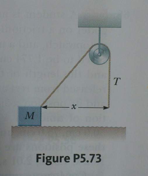

A block of mass 2.20 kg is accelerated across a rough surface by a light cord passing over a small pulley as shown in figure.The tension T in the cord is maintained at 10.0N,and the pulley is 0.100m above the top of the block.The coefficient of kinetic friction is 0.400m.
Determine the acceleration of the block when x=0.400.
Are there any mistake?
tanθ=0.4/0.1
θ=76.0°
F-f=ma
10sinθ-0.4x(2.2x9.8-0.1cosθ)2.2a
It is a mistake to present a problem like this without an accompanying diagram, and a mistake to attempt to solve it without drawing a forces diagram to help you.
You also haven't indicated the tension in the cord.

Okay, third mistake, you have attached the wrong pic!
Sorry again.
hi haha1234! :smile:
what is this? :confused:
haha1234 said:
(2.2x9.8-0.1cosθ)
(2.2x9.8-0.1cosθ) is the normal force of the block.
but 0.1cosθ isn't a force, it's a distance :confused:
Oh,i have made a stupid mistake.
I can find the correct answer now.
Thank you!
deleted
tanθ=0.1/0.4 <- check it.
