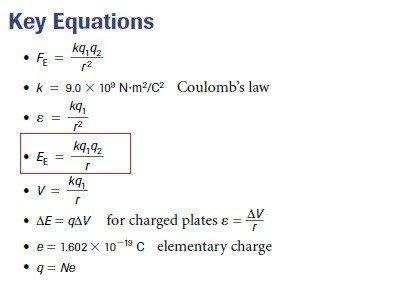

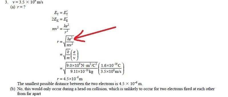

Hello, let's look at question 3(a). I just did that question, but I got different answer than the one in the book.
There is the book solution is in the attachment.
I'm concerned about a mistake in the formula. I think that there is no square in r. Even two pages after, you can see that there is no square there. How is this Possible?
  • Slide titled Key Equations listing: F_E = kq1q2/r^2; k = 9.0 x 10^9 N·m²/C² (Coulomb's law); E = kq1/r^2; E_E = kq1q2/r (boxed in red); V = kq1/r; ΔE = qΔV for charged plates; e = 1.602 x 10^-19 C elementary charge; q = Ne.

  • Handwritten-style worked solution from a textbook: energy equations E_T = E'_T and 2E_K = E'_E lead to mv^2 = ke^2/r^2, then r = sqrt(ke^2/mv^2), with a red arrow pointing at the square root term, followed by numeric substitution giving r = 4.5x10^-6 m.

Hi Freeq! :smile:
Yes, you're right. :smile:
The dimensions there are completely wrong (and the units at the end combine to m1/2, not m). :frown:
energy = qV = Fr = kq1q2/r not kq1q2/r2 :rolleyes:
(which book is this?)​
Nelson 12 Physics. It looks like they used formula for electric force, but not energy. However, I still think it is a good book.
