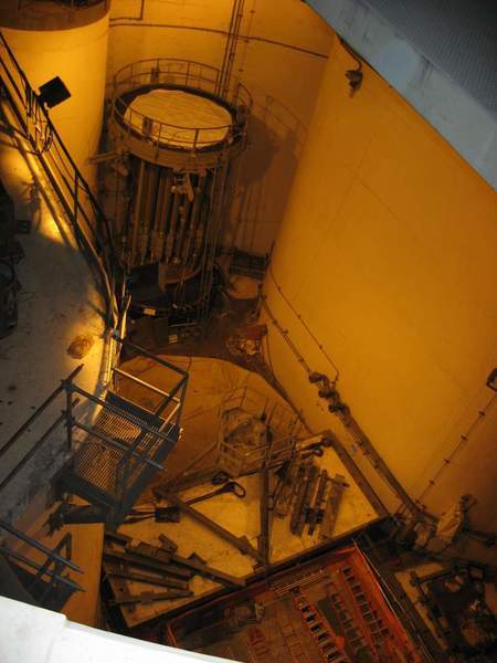

Looking down into the reactor pressure vessel (RPV) of a PWR during a refueling. The core is about 10 m (33 ft) underwater, and the glow is the Cerenkov radiation.
Now imagine trying to do measurements and inspections at 10 m. Nowadays, rad-hardened digital cameras are used. Measurements are done in the spent fuel pool with the fuel also under about 10 m of water.
A ring of studs or bolts sorrounds the opening of the PV. The tall posts are alignment posts. The upper head has to precisely align within a few mils (~ 1 mm) in order for the control elements and control rod drives to be directly over their respective fuel assemblies.
