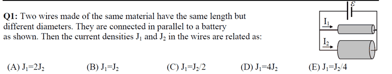

Fatima Hasan
315
Circuit diagram of two cylindrical wires of the same material, one thin and one thick, connected in parallel to a battery, with currents I1 and I2 labelled, followed by multiple-choice options comparing current densities J1 and J2.
##J=\frac{I}{A}##
A=π r2
Since I is constant and the diameter is doubled , A2 = π (##\frac{2D}{2}##)2
A2 = 4 A1
J2 = I/(4A1)
= J1 /4 → (E)
Is my answer correct ?

Fatima Hasan said:
Since I is constant
Are you sure?
cnh1995 said:
Are you sure?
##R=\frac{ρL}{A}##
The area goes up by 4 if the diameter is doubled. So, R2 = R1 / 4
##I=\frac{ΔV}{R}## ( I is inversely proportional to R )
I goes up by 4 . (I2 = 4I1)
J = I / A
J2 = ##\frac{4I}{4A}##
J2 = J1

Right.

The problem can't be solved since the diameters (or ratio of diameters) is not given.
(I realize the assumption of D2 = 2D1 is made here).
No, it is irrelevant, though all the wrong answers seem to assume the ratio is 2:1.
