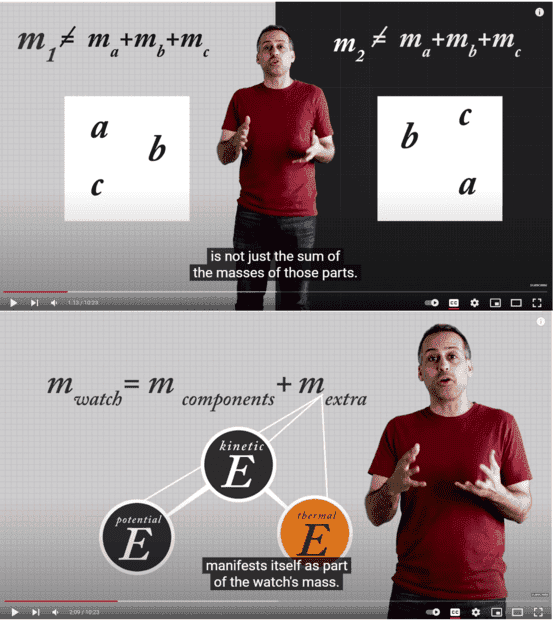

A very interesting and informative video, although I don't fully understand it as it still seems a bit contradictory to me.
The Real Meaning of E=mc²​
I was favorably impressed by the video. He had appropriate weasel words in most the places where he was oversimplifying. He used the modern notion of invariant mass and nimbly refrained from calling it that. He got into the notion that mass is not additive and went in depth into examples of both mass surplus and mass deficit. And he pointed out that mass is a property.
I was not fond of the final question since the idea of gravitational potential energy in the context of Special Relativity is something that does not really fly.
Listening for errors, the only one I spotted was the implicit use of the Bohr model of the atom. But it wouldn't be fair to call him out for that.
