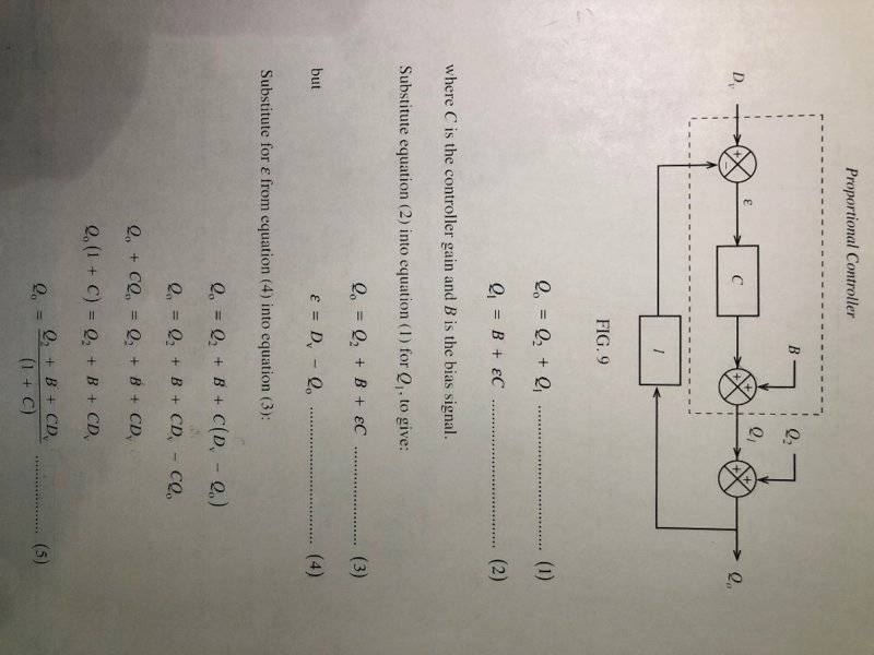

The proportional control system of figure 3(a) (attachment 235263) has an input, ##\theta_{1}##, of 10 units. The uncontrolled input, ##\theta_{2}##, has a value of 50 units, prior to a step change down to 40 units. The result of this disturbance upon the output, ##\theta_{o}## is shown in figure 3(b) (attachment 235264)
(a) Calculate the change in offset in the output produced by the step change
(b) Draw a modified block diagram to show how the offset could be minimised by the inclusion of another control action. Also, show by means of a sketch how the modification might be expected to affect the output response.
(c) Show, by drawing a modified block diagram, how the magnitude of the disturbance could be minimised by the inclusion of a third type of control action
2. Homework Equations
##\theta_{0}=\frac{\theta_{2} +G\theta_{1}}{1+G}##

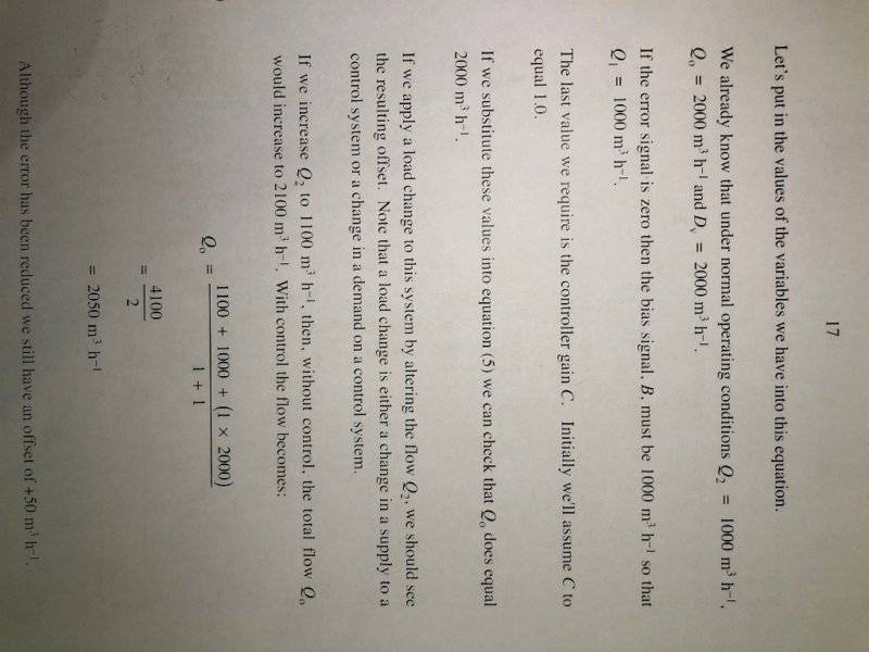

(a)
[/B]
Prior to the step change
##\theta_{0}## = ##\frac{50 + (9*10)}{1+G}##
so ##\theta_{0}## = ##\frac{140}{10}##=## 14 m^{3 h-1}##
After the step change
##\theta_{0}## = ##\frac{40 + (9*10)}{1+G}##
so ##\theta_{0}## = ##\frac{130}{10}##=## 13 m^{3 h-1}##
So in the first instance would I be correct in saying that the change in offset in the output as a result of the step change will be ## 1 m^{3 h-1}## ?
I attached some notes, (pages 16 and 17) which I think are in relation to this question

My approach may be too simple-minded, but the output plot looks like the initial output response is a decrease of 5 units. I don't know what m and h are.
Hello, the method you see above is the method I was given in my notes but I discovered another way of doing this using laplace transform. The answer from that method was very similar to this which makes me think my answers are close.
The m is for cubic meters but I have just realized that the question does not actually suggest and units so I may be wrong in using ##m^{3h-1}##
h is the feedback error I think.
I will post the laplace method in this thread during the next couple of days
The output response to the ##\theta_2## input is the same as the closed loop response of a negative feedback loop with ##G^{\prime} = 1## and ## H^{\prime} = 0.1 * 9 = 0.9## feedback gain.
I submitted this and it was marked as correct as per my working out in the first post. The answers to `b` and `c` just required a block diagram showing the addition of the integral action and the derivative action resulting in a block diagram of a PID controller. I will mark this as solved now but if anyone needs any help with this again I can advise.
