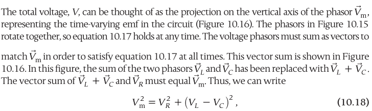

TL;DR
is the total voltage across all components in a series rlc circuit really equal to ##v_{L} + v_{C} + v_{R}## ?
my textbook said this
which I don't think is true, tho the textbook still said this (this equation is the true one)
so is the textbook right about the first equation?
figure 10.15figure 10.16
mymodded said:
TL;DR Summary: is the total voltage across all components in a series rlc circuit really equal to ##v_{L} + v_{C} + v_{R}## ?
Why not? The loop voltage is the sum of the individual voltage drops (and any voltage gains). How can it be otherwise? Are you trying to ask about scalar versus complex voltages somehow?

there is a question where we had to solve for the inductor's voltage which turned out to be about 500V, even though the AC source was only 12V and the only reason it made sense is because ##V_{m}^{2} =V_{R}^2 + (V_{L} - V_{C})^{2}## and ##V_{C}## was equal to ##V_{L}## (at resonance), so they cancel out, I don't know how the first equation holds true when the second equation holds true as well. Or it could be that it has something to do with one of them being a voltage drop while the other is a voltage rise. Also if the first equation ##V = v_{C} + v_{L} + v_{R}## is true, why do we have the second equation?
edit: I've got a question, in the equation ##V_{m}^{2} =V_{R}^2 + (V_{L} - V_{C})^{2}##, ##V_{m}, V_{R}, V_{L}, V_{C},## correspond to the maximum voltages, but does this equation hold true when the actual voltages (I mean when they are not at their maximum) are used instead of the maximum voltages? I know this equation is derived from adding the phasor vectors but I'm just wondering.
The KVL equation ## v_{C}(t) + v_{L}(t) + v_{R}(t) = v_{S}(t)## has instantaneous voltage terms. So, in your example ##v_{S}(t) = 12 \sqrt{2} sin(\omega t)##, etc. The ##\sqrt{2}## factor is because it's common to use RMS voltages when describing AC sources, but you could leave it out and just refer to peak magnitude.
The other equation ##V_{R}^2 + (V_{L} - V_{C})^{2}## is a calculation of the magnitude squared of the voltage sum. So, for example ##|v_{S}(t)| = |12 \sqrt{2} sin(\omega t)| = 12 \sqrt{2} = V_{S} ## or 12Vrms. Then ##V_{R}^2 + (V_{L} - V_{C})^{2} = |v_{R}(t) + v_{L}(t) + v_{C}(t)|^2##. Of course the phase of each voltage term matters when you add them up.

But wait, ##|v_{R}(t) + v_{L}(t) + v_{C}(t)|^2## is not necessarily always equal to the peak squared while ##V_{R}^2 + (V_{L} - V_{C})^{2}## appears to always equal the peak squared (as it uses the maximum voltage for each component) so how is that so?
Which textbook do you refer to?
The term ##|v_{R}(t) + v_{L}(t) + v_{C}(t)|^2## is the square of the instantaneous total voltage at time ##t##.

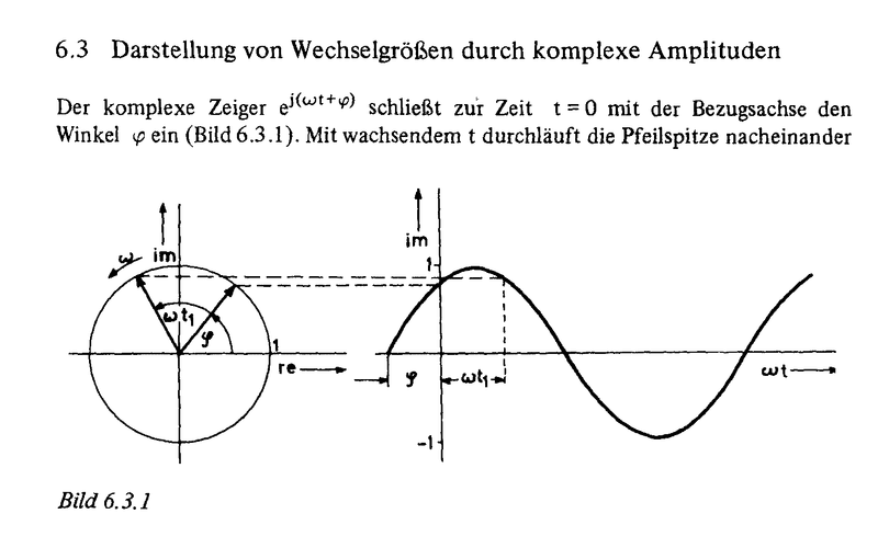

The overall complex impedance can be written as
## \underline {Z} = R +jX##
with ##R## = resistance and ##X## = reactance.
It follows the absolute value of the complex impedance:
##\left | \underline Z \right | = \sqrt{R^2 + X^2}##.
For a series LCR circuit a good way of analysing it is to first assume a current of 1 Amp. This is the same everywhere in the circuit. Then find the reactances, XL and XC. If 1 amp is flowing in a reactance of say, 10 Ohms, then the voltage across it is 10 volts. You can draw a phasor diagram where I is the reference and VX is then drawn leading it by 90 degrees and VC is lagging it by 90 degrees. VR is in phase with the current. It is then a simple matter to add the three voltages vectorially and find the voltage across LCR.
