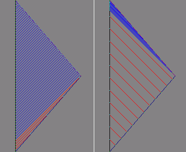

I said in post #11 that Adam and Bob are going to age (about) a couple years so let's say they travel away for exactly one year according to their own clocks and then turn around and get back to Charles in exactly one more year. We'll first deal with what happens between Adam and Bob and when we get done with that we'll figure out what goes on between each of them and Charles.
Now according to the Doppler Analysis, Adam and Bob will each see the other ones clock running slower than their own by the factor of 5.00250125×10^-4 (which is [STRIKE]1/1900[/STRIKE] 1/1999). So the first question we want to answer is what time will each of them see on the other ones clock when they reach the point of turnaround? The answer is simple--we multiply 1 year by 5.00250125×10^-4 (or divide it by [STRIKE]1900[/STRIKE] 1999), which is just a little over four and a half hours.
The next question is what Doppler Factor will apply at the moment of turn around? How fast will they each see the other ones clock ticking immediately after they each turn around? What do you think?

greswd said:
so, they should see each other's clocks ticking very quickly during the turnaround, and this will offset the previous effect?
No, that is not correct.
This would be correct for how Adam and Bob see Charles (but not how Charles sees Adam and Bob) so let's work on that relationship. Use the correct Doppler factors for how Adam and Bob see Charles's clock at the end of one year on their clocks and calculate how much they see Charles's clock progress. Then use the reciprocal factor for the return trip and see how much they see Charles's clock progress during their one year return. Add the two numbers together and you will have determined how much Charles has aged during their trips. What do you get?
Now think about what Charles sees when he looks at Adam and Bob. Using the same Doppler factors, figure out what time is on Charles's clock when he sees Adam and Bob reach one year and when he sees them turn around. Then for the remaining time that you calculated in the previous paragraph, you can figure out how much time on Charles's clock goes by while he's watching them return.
If you do all that correctly and if you understand what you are doing and why, you should be able to figure out why it is different when Adam and Bob look at each other. Can you do that?
Analysing Adam-Charles, wouldn't the effects of Doppler shifting be mutual?
The Doppler factors that you calculated in post #18, 44.71017781 and 0.02236627204, are mutual but they don't apply symmetrically.
In our example, when they first depart, Adam and Charles both see each others clock ticking at 0.02236627204 times their own. After one year on Adam's clock, he sees that Charles's clock has advanced by 0.02236627204 years (8.1636892946 days), correct? Then he turns around and now he sees Charles's clock ticking 44.71017781 times his own so in one more year he sees Charles's clock advance by 44.71017781 more years for a total of 44.73254408204 years. So Adam sees Charles's clock advance by 44.73254408204 years while his own clock advances by just 2 years.
Now what does Charles see? He is going to watch Adam's clock ticking slower than his own until it reaches one year because that is the time he sees on Adam's clock when he turns around, correct? So what time is on Charles's clock when that happens? Well, it would be the reciprocal of 0.02236627204, wouldn't it, which is 44.71017781 years. Now he sees Adam's clock ticking faster than his own for another year, correct? How much time progresses on his clock while that happens? It is the reciprocal of 44.71017781 which is 0.02236627204 years, correct? The sum of these two numbers, 44.73254408204 years, is how much time progresses on Charles's clock while he watches 2 years progress on Adam's clock.
So can you see how even though the same two Doppler factors apply for both Adam and Charles in watching the other ones clock, they don't apply for the same length of time according to each observer and that's why they end up with different times on their own clocks when they reunite?
Do you have any questions on what happens between Adam and Charles? If not, can you see why we can't do a similar analysis between Adam and Bob?

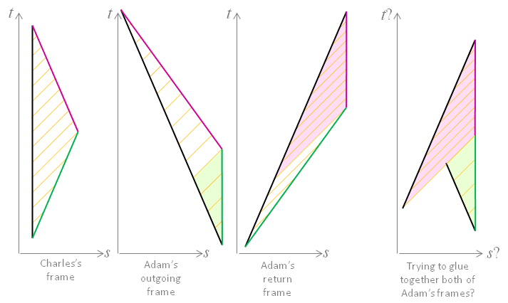

Aha brilliant! You nearly had me there. :)
So first, with regards to how Charles sees Adam. At first I thought there was a flaw because to Charles, Adam took less time to return. Then i realized, this was what Charles saw, and not what actually happened in Charles' frame.
After drawing an ordinary displacement-time graph, i find that you're absolutely right.
Now with regards to how Adam sees Charles. I have encountered your explanation three times already, from three different textbooks. Heh.
Let's say that in Adam's frame Charles emits light pulses at a regular frequency. According to your explanation, Adam spends half his time receiving signals at a redshifted frequency, and the other half receiving signals at a blueshifted frequency.
after drawing a graph, it shows that this is not the case. Like Charles, Adam should spend more than half the time receiving signals at a redshifted frequency.
By overestimating the no. of signals received at a blueshifted frequency, the paradox is apparently solved.
You were quite clever in connecting both frames together in order to demonstrate the asymmetry. However using that explanation i could also say that Adam only makes a turnaround after seeing 44 years elapse on Charles clock, by which 2000 years have elapsed for Adam.
Do note that a displacement-time graph does show that 44 years elapses for Charles before he sees Adam make a turnaround. Just that the reason for that is different.
Now some have tried to solve the problem by saying that distances for Adam are length contracted. I turned to a Minkowski diagram for the solution. However, it produces a time gap.
Naturally, this raises three questions. is some part of Charles' life "event cloaked" to Adam?
Why does the time gap only apply one way? Why is the time gap just the right amount, but not more or less?
Other than the time-gap explanation, we can use the GR explanation. As Adam experiences acceleration, he perceives himself to be in a stronger gravitational field than Charles. Therefore time passes more slowly for him.

You are the one that claimed to have a drawing.
However, one possible set of correct diagrams can be found at:
http://arxiv.org/abs/gr-qc/0104077
See figures 8 and 9, but I recommend reading the entire article.
greswd said:
if you say that drawing a graph doesn't contradict, could you link me to an image? We wouldn't want to be describing diagrams with words.
There is no graph, no analysis of any type that can contradict what the Doppler analysis shows because it describes what each observer actually sees and measures. All other analyses must agree with what I have described. It is such a simple description, I don't know why a graph is needed. But if you made a graph that you believe contradicts, maybe you should show it to us and maybe we can help you find your mistake.
Or you could state what you think is the mistake in the Doppler analysis. So far, the only thing you have indicated is that Adam will spend a different amount of time (according to his own clock) traveling a particular distance in both directions (going and coming) at the same speed but you haven't said why or given any support for such a notion.
Keep in mind that the Doppler analysis does not depend on identifying any reference frame where coordinate time needs to be defined according to synchronization of clocks. There is no coordinate time assigned in the Doppler analysis but if you choose to assign a coordinate system, it will provide exactly the same results as the Doppler analysis--how could it not?

Ok I haz graphs, crudely made with powerpoint.The orange lines represent individual light pulses. When we talk about frequency, we are referring to the frequency at which light pulses are received.
Here's the first graph, from Charles' perspective, and Charles is the one sending light pulses.
So it appears that Adam spends half the time receiving light pulses at a redshifted frequency, and half the time receiving blueshift.
http://imageshack.us/a/img145/5116/fesf.png
Now for the 2nd graph, this time from Adam's perspective.
As you can see, he's receiving light pulses from Charles.
http://imageshack.us/a/img829/7692/ccccx.png
He spends more time receiving pulses at a redshifted frequency.Follwing our interpretation of the first graph, Adam spends half the time receiving pulses at redshifted frequency, and the other half receiving pulses at blueshifted frequency.
But this contradicts the 2nd graph. I can describe what ghwellsjr was saying with this 3rd graph, which looks implausible.
http://imageshack.us/a/img4/1289/vvvvvi.png
Comparing the 2nd and 3rd graphs, we can see where the overestimation comes into play.
Described with 1st graph. This is why I said that you were absolutely right.
Described by 3rd graph.
