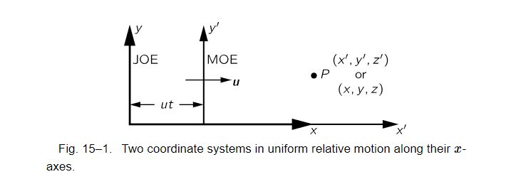

We are familiar with diargtrams like what I picked up from https://www.feynmanlectures.caltech.edu/I_15.html
for Galilean and Lorentz transformations. We learn the concept of coordinate systems or Frame of Reference.
Diagram of two coordinate systems in uniform relative motion along their x-axes: JOE with axes x and y, and MOE with axes x' and y', separated by distance ut, with velocity u pointing along x. Point P is labelled (x', y', z') or (x, y, z).
However, in some GR discussion, e.g., twin 'paradox' discussion, is FR concept not suitable ? Reading the comments this question comes to my mind.

anuttarasammyak said:
Well, I found some critics above about I referred FR for twin “paradox “.
If you mean posts in this thread, nobody was saying you can't use frames of reference. Of course you can. But you need to do so correctly. Posts in this thread have corrected wrong things that you said about frames of reference. That is not the same as saying you can't use them at all.
You can use frames to discuss the twin paradox, but there are a couple of points worth considering.
First, if all you are doing with the frames is having somebody be at rest in them then they are an unnecessary complication. Saying "A is at rest in system S and B is at rest in system S', where S and S' are inertial reference frames and S' is moving at velocity v with respect to S" is a very long winded way of saying "A and B are moving inertially with relative velocity v". If you are going to do some analysis with the frames (e.g. introduce S'' with velocity -v and explain the frame change simultaneity issues that lead to the "paradox") then you need to introduce them, but there's none of that in what you said.
The other point is the pedagogical one that @PeroK and I were discussing, that there might be better ways to teach the issues with simultaneity than calling a bad analysis of a scenario a paradox and then dumping it in students' laps and saying "here, it's broken, fix it". As PeroK points out, though, the "paradox" is out in the wild and we have to live with it, as well as dreaming of a better world.
