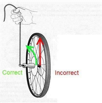

So I was thinking, I remember a physics experience where you hold and spin the wheel on a stick, if you hold the left side of the stick, the right side would stay up because of torque. Now if you assume the force of torque to be going up to counteract gravity and the other side of the torque where you hold the stick with the centripetal force of going away from a circle, can you sustain an object in mid air?

That's where you transfer the centripetal force using torque into an upward force. I suppose I was really not getting how the other side of the wheel around the stick manages to stay up.

A centripetal force would make it move in a outward direction, so just centripetal force and a lowering angle would work.
Nevermind, you still need an upward force, thanks for the video.
Gyro produce torques rather than linear forces. If you try to make a machine that self levitates by using contra rotating gyros they tend to bend the machine rather than lift it.
Line drawing of a hand holding a spinning bicycle wheel by its axle rod, with a green arrow labelled Correct pointing up and left and a red arrow labelled Incorrect pointing straight up from the hub.
