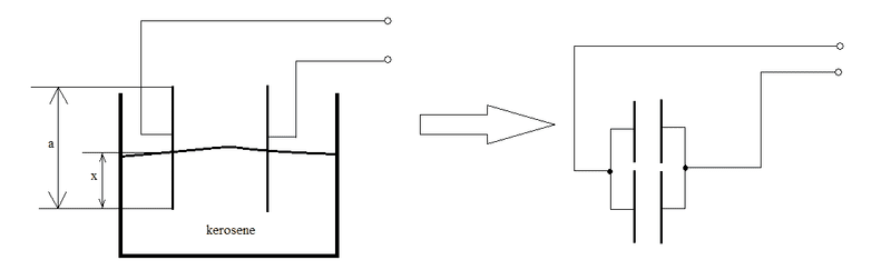

A flat capacitor formed by two square plates of side 0.3 m which are 2 mm apart. Source keeps voltage 250 V on the plates. What current flows between the plates and the source if the condenser is immersing in kerosene at velocity of 5 mm / s? The relative permittivity of kerosene is 2.
Here is a pic
I=Q/t
Because of the fact that immersing cunductor can be understood as two parallel conductors the capacity of an immersed conductor (the depth x = v*t) is C =(ε0*(a-x)*a)/d + (ε0εr*a*x)/d
My question is how do I compute the time in the x = v*t? And sorry for my english.

What equation? Remember your ultimate goal is to find the current.
I think I get it now...
I put the "v*t" instead the "x" in the equation for capacity, multiply it by the voltage (U) and then derivate it following I=dQ/dt
Or am I wrong?
Anyways thank you for your clear explanation, it helped me a lot
That's right. Or you could just leave it as ##x##, and when you differentiate with respect to time, you'll get ##v## in its place.
