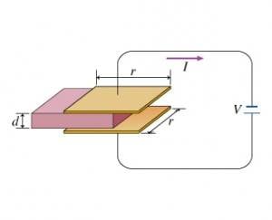

Hello,
1. Homework Statement
Assuming that the dielectric is inserted at a constant rate, find the current I as the slab is inserted.
Express your answer in terms of any or all of the given variables V, K, r, d, Δt, and ε0, the permittivity of free space.
[/B]
C = ε0 * A / d
[/B]
Q = CV
dQ = dC ⋅ V
I = dQ/Δt
C = ∈ ⋅ A / d = ∈⋅(xr)K / d + ∈⋅(r-x)r / d
dC = ∈⋅(r)K / d - ∈⋅r / d = ∈r(K-1)/d
dQ = dC⋅V
Therefore answer should be ∈r(K-1)V/(dΔt)
However, the correct answer is ∈(r^2)(K-1)V/(dΔt). That means the multiplier "r" is missing. What is wrong with my solution.
Thanks in advance.
The left side is a differential quantity. So, the right side should also be a differential quantity.
Oops, I have forgotten to include the dx multiplier. Thank you.
Dilemma said:
I = dQ/Δt
dQ is a differential quantity, but Δt is the finite amount of time required to completely insert the slab.
Did you mean to write I = dQ/dt, or maybe I = ΔQ/Δt?
