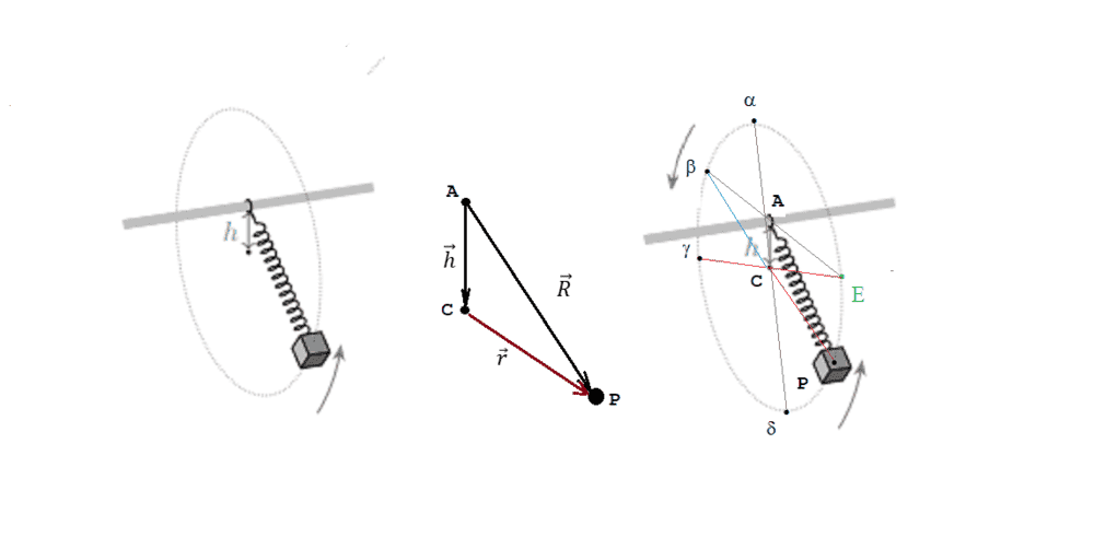

let be ##\vec r ## the position vector of the particle. A the spring has zero relaxed length, the spring force is -k ##\vec r##. the total force also includes gryvity. WE set the coordinate system with horizontal x-axis and vertical down y axis. The equation of motion in coordinates is
##m\ddot x=-kx##
##m\ddot y=-ky +mg##
This is a linear , constant coeffient, inhomogeneous DE. the solution of the homogeneous part is a two-dimensional vibration with angular frequancy
##\omega= \sqrt{k/m}## A particular solution of the inhomogeneous equation is ##h= mg/k## that corresponds to the steady state. For the new variables X=x and Y= y-h, the differential equation becomes ##m\ddot X = - kX## and ##m\ddot Y=-kY##. The solution can be a circular motion with angular frequeny ##\omega= \sqrt{k/m}##. and arbitrary radius R. Then the speed is constant, ##\omega R##..
The problem maker might have took that straightforward, when assuming constant speed.

But gravity can be eliminated from the equation of motion by simply moving the origin : y→ y+##\frac {mg} k## This constant translation cannot change any velocities. It does change the origin to C
I am frankly mystified that there is an argument here.

hutchphd said:
What I said was much stronger than that and much simpler. With a simple change in origin, the equations of motion have complete circular symmetry and no longer contain the gravity constant g.
What is there to discuss? (If I seem vexed it is because I am! This is just a simple truth. If you feel the need to describe the springs in gory detail then OK we can do that but it cannot change the result)

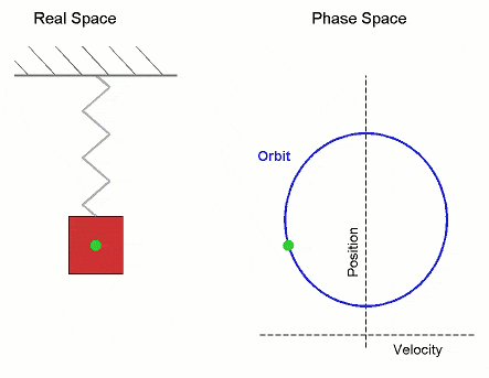

From: https://en.wikipedia.org/wiki/Simple_harmonic_motion:
(edited to freeze the animation)
No-one who has done (or even witnessed) a bungee cord jump would suppose that the velocity is constant, but some might be surprised that the period and frequency are (ideally) constant

Tension on the spring points inward from the circle to its center, while the gravity always points downward.
If the weight is moving counter-clockwise:
then on the left side of the circle, $$\frac {v^2}r=\frac{mg+T}m,$$so$$T=m\frac{v^2}r−mg,$$ and on the right side of the circle, $$\frac{v^2}r=−\frac{mg+T}m,$$so$$T=\frac{mv^2}r+mg.$$The spring alternates between storing the acceleration of gravity on the downward part of the circular path, and restoring it compensatorily on the upward part of the circular path.

The equations for the x and y coordinates
##m\ddot y=−ky+mg##
##m\ddot x=−kx##
ensure circular motion with constant speed, see Posts #61 and #82 for example. A constant external force does not make vary the vibrational frequency of a string-mass system, and if that motion is circular, the speed is constant.

  • #88
sysprog said:
How then does the trajectory get to be circular, as in the drawing in the problem description? ##-## this version has the original, along with @TSny's vector diagram (which has ##\vec h##, where the original drawing has ##h## next to a ##\updownarrow## segment), and my syncresis from those two renditions ##-## I think that at point ##\delta## a tangential acceleration would be horizontal, and the spring tension is orthogonal to, not diametrically oppositional to, the horizontal exorbital tangent, and so coerces orbital, rather than linear, trajectory.
At point δ there are no horizontal forces, so no tangential acceleration.
I didn't understand the last bit, about linear trajectory. Are you arguing against circular motion now or against the special case of linear reciprocating motion that @TSny mentions?

  • #90
I'm grateful to @haruspex, @hutchphd, @TSny, @ehild, for responding to my meanderings regarding this matter, and to @guv for posing the problem and commenting regarding the responses.
When I was earlier today at the grocery store, although I was trying to be not too conspicuous, despite my desperado-style SARS-II COVID-19 kerchief, I went to the brink of consternating one or two members of the staff, by conducting a few crude experiments with the produce scale, which looked pretty much like this:
The one there was branded Ohaus, but it looked pretty similar otherwise. It had an attached ring (not present in the image here presented) above the 0 numeral, by which it was hanging from a hook attached to a substantially heavy steel frame.
The results of my necessarily overly hasty experiments confirmed nothing firmly, except that when I pushed and held mostly horizontally and somewhat upward at the U-shaped fixture below the ##\text 5## numeral, the red needle continued to point pretty much straight up, so that it was indicating a little below the ##\text 9## numeral on the scale, and that result was not inconsistent with my surmises regarding the tension and the effects of gravity and of opposition thereto thereon.
I think that my hope that I won't have to resort to doing second derivatives and definite integrals to try to clarify or justify, even to myself, what I've already said here about the velocity may be in vain.
