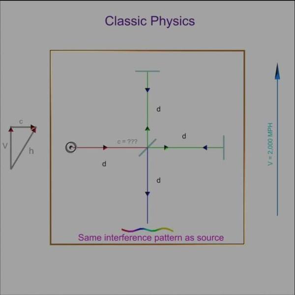

I found a verry simple mistake in the Michelson Morley interferometer experiment. If I understand it right, both of interference patterns were the same, right? We have to take into account for two frames of refference though. One for a person observing from Earth, and one for a person observing from a stationary point somewhere in space. The interferometer experiment was made in the Earth's frame of refference which was moving, with the Earth, and there was no experiment for the other frame of refference. Classic physics also proves that this frame of reffernce will not show any difference in the interference patterns. So both theories can NOT be correct. If you now use the theory of relativity for a theoretical frame of refference in space, it will prove that both frames see the same thing (same interference patterns on the table), because relativity says that the speed of light is constant. This is not correct, however, since if we do not "attach" our selves to thinking that light speed is constant ie. fastest, the theoretical stationary frame of refference (from space for say) must show a difference in speeds from the two observation points. Classic physics shows this, if we use a slower speed. I have drawn a simple explanation of this on paper, using a traveling fly. If you want I can post it later, but it is really simple to show this yourself.
The Michelson Morley experiment was based on the assumption from classical physics that light was a vibration in a substance filling all of space known as the luminiferous aether, akin to sound waves in air. Sound waves always travel at the same speed relative to the medium they are vibrations in--even if you're moving at a high speed relative to the air, if you make a noise the sound wave will still travel at the same speed relative to the air's rest frame as a sound made by someone at rest relative to the air, which means that relative to yourself sound waves aimed in different directions will travel at different speeds (because they must travel at the same speed relative to the air's rest frame, and you are moving relative to this frame). If light worked the same way, we would expect that if the Earth had a significant velocity relative to the luminiferous aether, observers on Earth would see noticeable differences in the speed of light relative to themselves when the light was traveling in different directions. And the MM experiment was repeated at different points in the year, so even if the Earth happened to be nearly at rest relative to the aether at one point in its orbit, it was assumed it would have a significant velocity relative to the aether at a different point in its orbit.
Yes, you are absolutly correct about sound waves, and frames of reference. I did not say however that aether exists. That was an assumption that physisists made a long time ago. Even if aether does not exist it doesn't prove relativity, because nonexistance of one thing does not prove existence of another thing - they have to be related somehow to make that conclusion. To disprove one theory all it takes is one experiment. Simple logic. I'll draw the MM experiment with two frames of refference and you'll see what I am talking about.

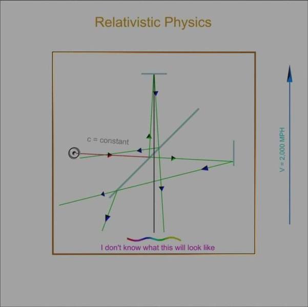

If you think that relativity would predict a shift you're confused. It doesn't matter what frame you analyze it from, all frames make identical predictions about local events like whether two wave crests reach the detector at the same time or different times. And analyzed from the rest frame of the detector, it's obvious that if light travels at the same speed in both directions in this frame, there will be no shift (if you want to analyze the same situation in a different frame, you have to take into account length contraction which will change the length of one or both of the interferometer's 'arms' in any frame where the interferometer is in motion).
What "other frame of reference"? There is NO "stationary point"! The Michelson-Morley experiment was done a number of different time, at different points in the Earth's orbit. The only way it could have come to a null result if it were always oriented in the same way relative to the "aether".

HallsoIvy, hi. I think there is always a stationary frame of refference, say one person is standing on the Earth and watching a moving train, and then there is another person on the train - there are the two frames. Everything moves in space so it would be kinda hard to find the exact null speed, you are right. Since the experiment was done on Earth, the frame of refference was basically "on the train," and always moving, not just around Earth's orbit, but also around the sun etc etc... Here are the pictures I've mayed, the first is for classic physics and the second one is for relativistic. I don't know how much simpler I could make it... I'll write the equations:
These are the classic physics equations:
d/c + d/c + d/c + d/c = 4d/c <- t1 for horizontal light.
d/c + d/c + d/c + d/c = 4d/c <- t2 for vertical light.
so t1 = t2 for both paths, and of cource there is no shift in patter!
As you can see the values are exactly the same, now there is no point in writing the relativistic equations, because like I said if classic physics are right then the relativity is wrong. You can try and do the relativity eqs, but you'll see that they will not be equal, even if you manage to get both light beams into the interferometer...
That is all I am trying to show, and I am just showing proof, and not arguing...

WarpSpeed, did you consider the effects of length contraction on the arms of the interferometer in the frame where the interferometer is moving? If you do you'll find that this frame also predicts there will be no shift in the pattern.

I note that you have the speed of light being c on both arms. That is the core of relativity.
I think you are confused about which theories say what.
What is "classic physics"? Which light propagation model? You said no aether, so it can only be ballistic theory of light, which is consistent with the MM-result but disproved by other observations:
May remind you of yout own words: "and I am just showing proof, and not arguing...". So please prove that Relativity is not consistent with the MM-result

Hmmm, no, do you mean that objecs contract when they move fast where relativity would play a role?
BTW I am not trying to argue, it's just that I try to use my knowledge of physics to my best ability and I am always learning. I could be wrong I account for that when I write, and didn't want you guys to think that I act like I know everything. I am just trying to keep this descussion proffesional, with proofs to back up my reasoning.
So if you can show me a proof that I was wrong I'll accept it as is, I don't argue with things that are right like math and geometry, because these are basically the axioms and always exist and can't be prooven wrong.
For now all I can say is that relativity has very percise formulas and definitions, if even one small thing is missing from the proofs it could lead to a very wrong conlusion.

So a little more about my reasoning. I think, if classic physics show no shift, and relativity shows no shift due to mirrors and arm lengths being contracted, then it leads me to another question. I'll try to explain the way I see it. The basis of the theory of relativity is that the speed of light "c" is always constant, and changes speeds slightly in different substances. The basis of classic physics is that light can go faster or slower depending on the frame, from where it originates, and not just being hindered by materials. Am I right? So what I think, if I am correct, is that in the first picture light actually travels at the speed "h" as you can see on the left of with vectors. Meaning that "c" depends on the speed "V" of the frame. And here is my aching question... How can it be that if the two basisis are different but imply the same conclusion? What do you guys think about this statement?

Yes, this is called length contraction. Basically if an object has a length L in the frame where it's at rest, then if you go to another frame where it's moving at speed v, its length (in the direction of motion) is shrunk to [tex]L*\sqrt{1 - v^2/c^2}[/tex].
So, say the two arms of the interferometer are each 10 light-seconds long in the interferometer's rest frame, at right angles to each other. Then in another frame where the apparatus is moving at 0.6c in the horizontal direction, the vertical arm is still 10 light-seconds long but the horizontal arm is shrunk to 10*sqrt(1 - 0.6^2) = 20*0.8 = 8 light seconds. Now say two wave peaks are released simultaneously at the intersection point, one going vertically and the other going horizontally. The peak traveling horizontally is traveling at 1c while the end of the horizontal arm is moving away at 0.6c, so the closing speed is 1 - 0.6c = 0.4c, and if the arm is 8 light-seconds long in this frame, it takes 8/0.4 = 20 seconds for the peak to catch up with the other end of the horizontal arm. Then the peak is reflected and travels back towards the intersection point, now the intersection point is moving towards the peak at 0.6c so the closing speed is 1.6c, meaning it'll only take 8/1.6 = 5 seconds to travel from the far end back to the intersection point. So, the peak takes a total of 25 seconds to go from the intersection point to the end of the horizontal arm and back.
Now consider the peak traveling along the vertical arm. In 12.5 seconds, the vertical arm has moved a horizontal distance of 12.5*0.6c=7.5 light seconds, and its vertical height is 10 light seconds, so by the pythagorean theorem if a signal takes 12.5 seconds to travel from the intersection point to the top, it'll have gone a distance of [tex]\sqrt{7.5^2 + 10^2}[/tex] = 12.5 light seconds, showing that the signal was moving at the speed of light. So, this must be the time for the light to get from the intersection point to the top of the vertical arm. In another 12.5 seconds it'll have traveled back down to the intersection point, so the light takes 12.5 + 12.5 = 25 seconds to travel from the intersection point to the top of the vertical arm and back to the intersection point. So you can see that both peaks take 25 seconds to travel from the intersection point to the end of their respective arms and back to the intersection point, meaning there will be no shift, even though we analyzed everything from the perspective of a frame where the interferometer was moving at 0.6c rather than being at rest (and assumed both peaks moved at c in this frame).
Ok. But consider this. When the light at 1c goes verticly it takes 10*1c = 10 light seconds to travel up along the vertical arm. When it goes down again it also takes 10*1c = 10 light seconds. Now, you have to use the pethagorian theorem for the light to catch up to the mirror at the top (because it has moved a distance of 0.4 light seconds), and... you can't.. why, because the light once it's fired never changes direction so it still shoots up verticly as it came from the intersection point - this is by relativity so I am not changing the subject (light speed, more correctly velocity because it's a vector, is not effected by the source, correct?). And more so, the light direction has to change so as to fire right at the top mirror (or where the mirror will end up after), it can't go streight up since the mirror will be long gone in the horizontal direction. So now even if we were just to change the angle of reflection to a bigger angle, aming right at where the top mirror will be after 0.4 light seconds, to make it there the light speed has to be bigger... simply because of another pythagorian theorem.
Here is the proof: "x" - hypotinuse of the triangle along which the light from the intersection point travels to the moved top mirror (we agree that all of the mirrors have moved horizontally right?); "a" - bottom triangle leg along which the theoretical light travels at 1c for 0.4 light seconds; and "o" - vertical leg of the right triangle where another theoretical light has to travel at 1c for another 10 light seconds when the system is stopped. Say we drop the speed of the table form 0.6c to a still (I don't want to fly in that ship lol) right when the light along the x direction hits the top mirror, but now we go back to the theoretical lights. a = 1c; o = 1c and so x = [tex]\sqrt{1^2c + 1^2c}[/tex] = [tex]\sqrt{2}[/tex] c. And there you have it's a contradiction. That is what I meant by the second picture I posted, by relativity the light will never hit the interferometer espetialy at speed like these.
Do you mean it took a time of 10 seconds to travel up? If so, this is only true in the interferometer's rest frame. In the frame where the interferometer is moving at 0.6c, it takes longer (12.5 seconds, as I showed), since the light has to travel both the vertical height of the arm and the horizontal distance that the arm has traveled between the moment the light left the bottom and the moment it reached the top.
No, that's incorrect, the speed is independent of the velocity of the source, but the velocity is not, because the direction does depend on the velocity of the source. A beam fired from a flashlight or laser pointed vertically upward will be have a vertical path in the rest frame of the flashlight/laser, but if the flashlight/laser is moving horizontal, the beam will have a diagonal path, so that it always stays directly above the flashlight/laser.
No, in relativity the speed is the same, the time to go from top to bottom is different. This is related to time dilation in relativity, in which a clock runs slower in a frame where it is in motion than it does in its rest frame (light bouncing up and down the arm can be considered a form of clock, read here for a discussion of how the time dilation equation can be derived from the so-called 'light clock' experiment).
My derivation was already based on considering the two legs of a right triangle to find the diagonal distance traveled by the light. Again, I showed that if we postulate that it takes 12.5 seconds for the light to travel from top to bottom in the frame where the interferometer is moving, then the horizontal distance will be 7.5 light seconds (since 12.5 seconds * 0.6c = 7.5 light seconds) and the vertical distance was 10 light seconds, so by the pythagorean theorem the diagonal path length would be 12.5 light-seconds in this frame, so the light would indeed be traveling at 1 light-second/second in this frame.
