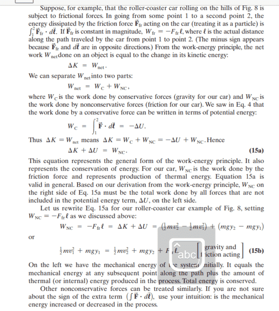

@drmalawi let me show you a small piece of the textbook to why I do it this way
You don't have to I know what you mean now, I just wanted to give you a little advice on being meticulous regarding definitions
if this is not clear, I can make a picture from my actualy textbook if necessary, this is an online pdf version
as can be read here, It only becomes negative once ##W_{NC}## is changed with ##F*displacement## hence that is why I use it like this.

A lot of ambiguity is avoided if one thinks of the Earth-roller coaster as an isolated system, i.e. no external forces do work on any of its components, which is the case here. Then total, not just mechanical, energy K+U, is conserved. The energy conservation equation is written in terms of differences, the sum of which is zero. In this case we have changes in kinetic, potential and thermal energy of the system $$\Delta K+\Delta U+\Delta E_{\text{therm}}=0$$ The changes are, of course, always ##Final - Initial##. When one puts the numbers in., the change in thermal energy comes out positive because the temperature of the brakes, which are part of the system, rises without a corresponding decrease of temperature elsewhere in the system.
I note that this view is consistent with the statement in the textbook excerpt, end of next to last paragraph: "Total energy is conserved." In my opinion, total energy conservation is much easier to implement than having to deal with work done by conservative and non-conservative forces.

Exactly.. that is what got me confused the first time round. I mean I get it now, but yeah.. You see energies and all of a sudden a work done, not considered as an energy, that was the confusing part back then. It's dependent on the system that you have chosen, but hey try to figure that out when it hasn't been stated explicitly, or I would say stated once kind of vaguely and not repeated.
And that's why I actually reverted back to the work-energy principle, I start from there and see which forces can be converted into an energy. i.e. the conservative forces.
Next time if asked such a question I'll just consider the system that also exerts that not-conservative force to find out what the ##\Delta E_{TH}## is. So thanks for that.
