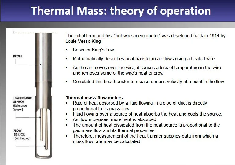

Hi,
What’s the difference between two similar sensors: thermal mass flow sensors (see attachment) and thermal flux sensors at https://vatell.com/index.php/thermogage. For me the former one is used to measure gas flow. What about the latter? Must there be gas for thermal flux sensors?
Thermal mass flow sensors measure mass flow, normally of a gas such as air. The output has units of mass per time, such as kg/sec.
Thermal flux sensors measure heat flow. The output has units of power per area, such as watts/cm##^2##. A good explanation is in the Thermogage User's Guide: https://vatell.com/images/Use of Thermogage v2.pdf. This is a link in the vatell.com link in the OP.
There are two cases for thermal transfer: with or without gas.
With gas: Can thermal flux be calculated with flow measurement?
Without gas: Is this the case only in vacuum?
