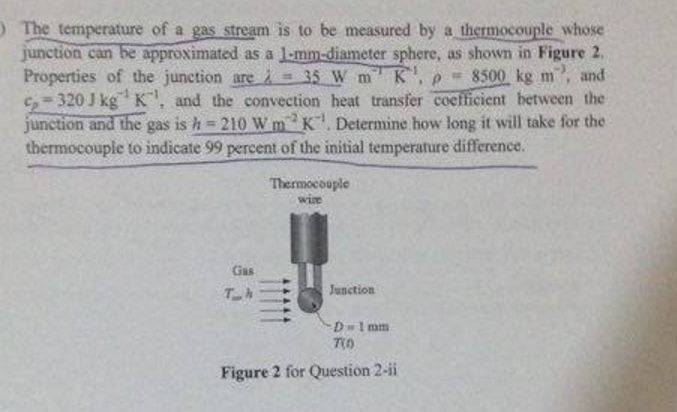

I do not know exactly how to start this problem.
I would really appreciate it if you could give me some hints.
I know that e^ - t/tau=T(t)-Twall/Ti-Twall
where tau=m*cp/hA
where h=convective heat tr.coeff
and T(t) is desired temp that we need to get to.
The exercise says that T(t)=99%Tinitial
We also know that tau=mcp/UA=mcp/hA

This is all the info I have
Exercise:http://imgur.com/a/apwob
Formulas:http://imgur.com/a/nQGCp

Do you not have the density of the junction material? You also know its radius...
Thank you for you answer.
By having D, I can get A=pi*D^2/4
and Density I have it as 8500kg/m^3
A*density*velocity=m_dot
I do not have the velocity, I can get it from Dittus-Boelter , however I do not know the viscosity Mew
The only thing you really need to know about the gas is the heat transfer coefficient. The M in the time constant formula is the mass of the junction material.

Thank you for reply,they do not provide me with M of junction material, how to find it?
They give you its material density. You also know its geometry. How does one find the mass of an object given its density?
ro=mass/volume
=>m=ro*V
williamcarter said:
ro=mass/volume
=>m=ro*V
So what's the volume of the junction? What's its density? Hence, what's its mass?
so m=density*Vol
density=8500kg/m^3;
Vol=vol sphere=4/3*pi*r^3=4/3*pi*(10^-3/2)^3=5.23*10^-10 m^3
=>m=8500*5.23^10^-10
m=4.45*10^-6 kg
Asphere=4*pi*r^2
Now tau=m*cp/h*A
tau=4.45*10^ - 6 *320/210*4*pi*(10^-3/2)^2
tau=2.21s

Okay, so ##\tau## is about 2.2 seconds.
Now you need to work on the exponential decay formula.

t(time)= - tau *ln(T(t)-Twall/Ti-Twall)
I need to know Tinitial,Twall and he said that T(t) is 99% of initial difference
Start with the formula as given in your Relevant Equations image. You should be able to place ΔT's into the temperature difference specifications.
T(t) is 99% of initial temp difference
=>T(t)=99%*(Ti-Tw)
but e^ -t/tau=T(t)-Twall/Ti-Twall
now this becomes e^-t/tau = 99%*(Ti-Tw)-Twall/Ti-Twall
However I do not know Twall.
I am stuck here

The temperature portion of the given expression is:
$$\frac{T(t) - T_{\infty}}{T_i - T_{\infty}}$$
But ##T_i - T_{\infty}## is the initial ##\Delta T##, right? So what might ##T(t) - T_{\infty}## represent in terms of ##\Delta T##?

99%deltaT?
Then time t= -tau*ln(99/100)
t=0.022s
williamcarter said:
99%deltaT?
t=0.022s
Nope. 99% of the ##\Delta T## is "used up". What remains?
Ow yes,you are right, my bad ,I read that up wrong.
It will be 0.01 or 1%
t= - tau* ln(1/100)
t= -2.21* ln(1/100)
t=10.17s
Good. Compare this with the "engineer's rule of thumb" approximation.
time constant tau =2.21
t=10.17s
Applying rule of thumb multiplying tau by 5
gives
5*tau=11.05 seconds, close to our t(that is 10.17s)
