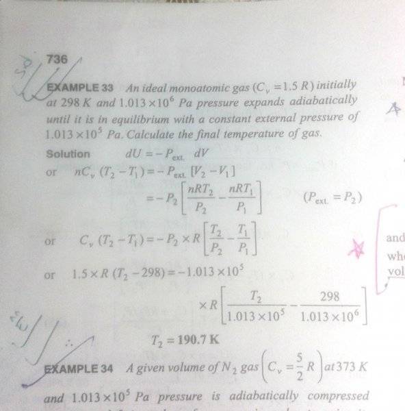

I am uploading pics of this question and the next one in which they've put final pressure equal to the external pressure.
yes in the example (33) it says among others "until it is in equilibrium with a constant external pressure". This statement essentialy means that [itex]P_f=P_{ext}[/itex]. In the example (32) there is no such statement, it just says "till the temperature drop to 275K".
Okay...! Now it's clear to me... in the example 32 the pressure may lie between anything from 10 atm to 1 atm... whereas in the 33 rd example it is given that the equilibrium pressure is equal to external pressure therefore in that we can say that external pressure = final pressure but not for the 32nd example. Now I get it. Thanks for your guidance :).
