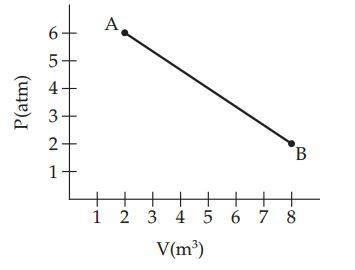

A gas expands as shown in the graph. If the heat taken in during this process is 1.02 × 10^6 J, the change in internal energy of the gas (in J) is

1.
E=Q+W
E=1.02*10^6+[-p(V2-V1)]
E=1.02*10^6-(6-2)(8-2)
It seems incorrect
kelvin56484984 said:
1.
W= -p(V2-V1)
Incorrect. p is not constant with V.
E= Q+W
Right. Get the right W.
