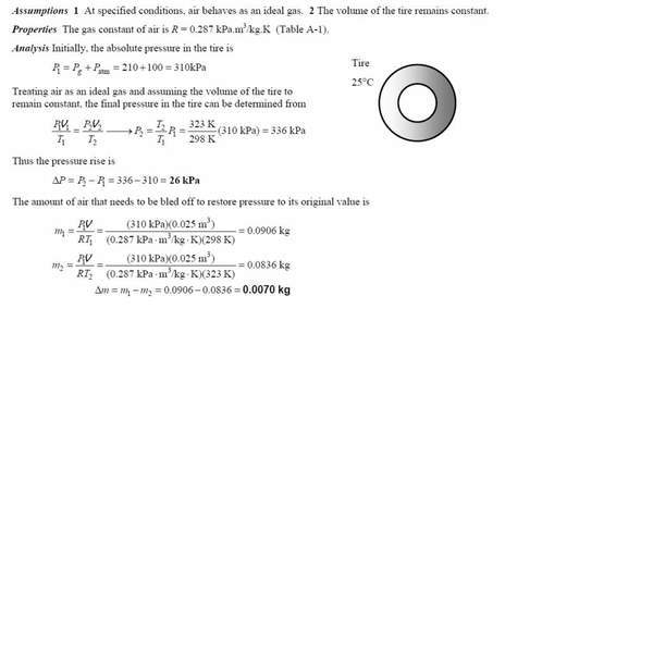

Doesn't that mean the temperature is constant in the equation and the pressure is changing, not the other way around like they have it in the 2 equations at the bottom that solves for mass??
My professor said the solutions was right, but I don't see how. Am I misinterpreting something?

Firstly they solved for the mass at the initial temperatre to get m1.
Then they found the mass at the final temperature m2
the mass needed to get bled off was m2-m1.
Alternatively, the pressure change that was required was 26 kPa within 0.25 m3 at 50°C. So you could have used the mass from that.
