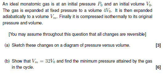

2. PV^y = const, y=Cp/Cv, PV=nRT, 3.
I've drawn the cycle for part a) of the question, but I'm not sure how to do part b). I know I need to relate Vm and 4Vo using the PV^y = constant relation but I'm stuck as to how to do it.
Using that, write an equation relating P0, V0, Pm and Vm.
Thanks, I think I got it now. Just to confirm, would P_m = P_0/32?
Yes.

Sorry to bother you again but the next part of the questions asks to determine the work done, heat transfer and change in internal energy in each process. So if we consider the first, isobaric process then the work done on the gas is simply Won = -P0 * (4V0 - V0) = -P0 * 3V0. To calculate the heat transferred (Q) and change in internal energy (ΔU) I can use the first law of thermodynamics, but the equations for Q and ΔU involve variables that I don't know. ΔU=nCVΔT and Q=nCPΔT. I don't know how to get either Q or ΔU if I don't know n (moles) and change in temperature.

Try it algebraically, also making use of the ideal gas law, and see how it plays out. I think you will be pleasantly surprised.
Chestermiller said:
Do it "per mole."
ΔU=CVΔT and Q=CPΔT? But the temperature differences are still missing. I tried to do P0V0/T1 = P04V0/T2 ⇒ T2=4T1 but that doesn't give a change in temperature
$$nT_0=\frac{P_0V_0}{R}$$
$$nT_1=\frac{P_0(4V_0)}{R}$$
$$nC_v(T_1-T_0)=C_v\frac{3P_0V_0}{R}$$
For a monoatomic gas, what is the molar Cv in terms of R?
Molar Cv = 3/2 R? Sorry I'm still confused
$$\Delta U=nC_v\Delta T=\left(\frac{3R}{2}\right)\frac{3P_0V_0}{R}=?$$
