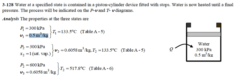

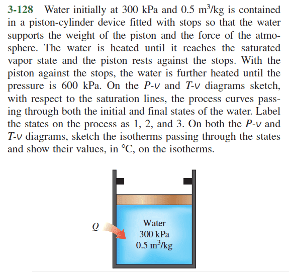

Why is the temperature of the first state is 133.52oC?
If at 300kPa & 133.52oC, from the ‘Saturated water—Pressure table’, it would give vf=0.001073m3/kg, far different from the specific volume as stated in the question which is 0.5m3/kg. Why don’t we need to consider the specific volume v1 in this question?
If mass, temperature and pressure are all stated the same, is it reasonable that the specific volume is much larger than the theoretical one?
Thank you very much!
What is the specific volume of saturated water vapor at 300 kPa?
vf:0.001073 vg:0.60582
do you mean it is a mixture of liquid and vapor?

Yes. That's what I mean. The 0.5 is the weighted average of the vapor and liquid specific volumes.

If the liquid is saturated, at equilibrium, the vapor must be saturated too. In this system, the average specific volume of the mixture of liquid and vapor is somewhere between that of saturated liquid and saturated vapor. This means that part of the water is saturated liquid and part of the water is saturated vapor.
In going from state 1 to state 2, all the remaining liquid evaporates, and the temperature and pressure remain constant.
