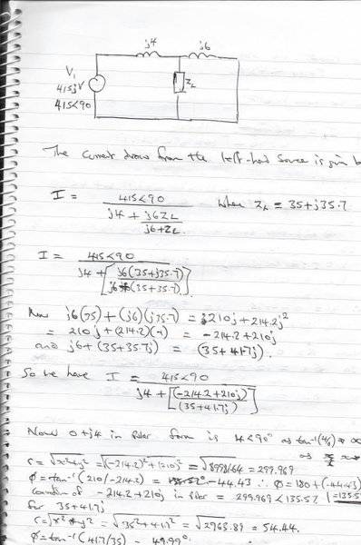

I wonder if someone could point me in the right direction i have completed the first part and obtained
IL = (15296.9 + j2390.4) / 26761 = 5.71503 + j0.89037
I have being doing the superposition part and after doing the calculation about 6 times i have come to the conclusion i have the original equation wrong
I have used from the 2 voltage sources (V1=j415 and V2 =415) where ZL = 35+35.7j from part a
ILH = j415/ (j4 + ((j6)(ZL))
IRH = 415 / j6 + ((j4) + ZL)
the answers i obtained were
ILH = 43.61 +1.95j
IRH = 0.868 = 42.43j
I am not sure where i have gone wrong, i am not looking for the answer just a point in the right direction please
  • #164
Hi Davey345, Welcome to Physics Forums!
Can you show more detail for how you arrived at your expressions for ILH and IRH?
Remember, when you suppress a voltage source you replace it with a short circuit (wire), but anything in series with that source is still part of the circuit.
  • #165
Sorry the images ore not fantastic, i am still in the rough working out stages. I have put a short circuit across the Voltage source V1 and taken the currents from that source and repeated the exercise from V2 i believed.

  • #166
The equation comes from the Current division in a circuit, i have said that the current through the circuit from the source is
J6 and ZL are is series and in parallel to j4 so with current divider rule resistors and impedances in parallel are the product of the two resistors over the sum.
and then i have used ohms law to obtain an equation for the current
  • #167
I'm not so much interested in the mechanics of the complex number handling as the methods/steps taken.
I'm not following your description. It looks like something got lost in the editing.
Lets deal with the active V1 source first. If V2 is suppressed then ZL and j6 are in parallel, and j4 is in series with that parallel pair. You can find the total current as an intermediate step, then apply current division for the parallel pair to find the load current. Is that more or less what you've done?
  • #168
The currents that you gave in post #163 correspond to the source currents. I can confirm that they are good (or close enough) values for those currents.
All that would remain is to apply current division to each to pull out the load branch currents and then sum the results.
  • #169
Oh Thank you, I forgot that last step.

To solve using Thevenin equivalents, you must find the Thevenin voltage and Thevenin impedance. To find the Thevenin voltage, you remove the load ZL and find the voltage across the terminals where the load was. To do that, you solve:
##\frac { VTh-V_1} {j4} + \frac {VTh-V_2}{j6} =0##
where Vth is the voltage at the node where ZL was connected.
