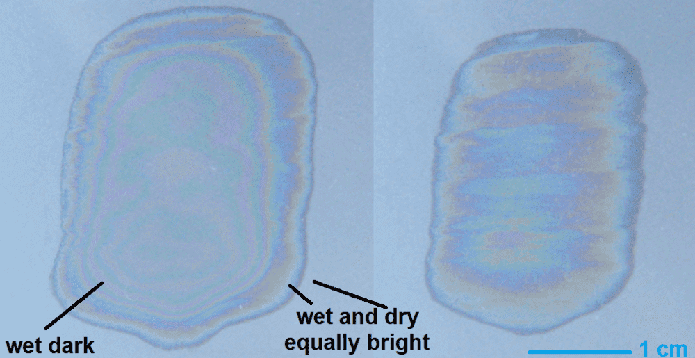

What is the minimal thickness of dark wet spots on drying dishes?
A common observation when doing the dishes is that the wet spots on a drying dish are darker than the dry spots, especially if the dish is held in such a way that it reflects the light of the sky. Evidently the total reflection coefficient is reduced by the water film. The border between dark and bright is acute. My question is, at what thickess does the wet film stop being dark, would a thickness of a single molecule still be dark?

My starting post was inadequate, wineglasses are a better example of the phenomenon than dishes, because diffuse reflection can be ignored. So let me try again. Take a wineglas or flat window glass, against a black background. Make the surface partially wet and notice that the reflection of the sky is darker on the wet parts. The wet parts are darker because of the reflectivity R. If the wet film is thick, R = ((n1-n2)/(n1+n2))2 + ((n2-n3)/(n2+n3))2, independent of the thickness of the film.
I suppose my question is, what is the formula for the reflectivity if the thickness of the wet film is much smaller than the wavelength. Is the thin film reflectivity noticably different from the thick film reflectivity. What is the reflectivity if the layer is one molecule thick.

Thanks. Your suggestion seems to be that I should restrict my question about the reflectivity of very thin wet films to polished glass surfaces. Ok. If the wet film on a polished glass surface is very thin (<<λ), the amplitudes of the reflections from both interfaces (air/water and water/glass) should be added. So Rwet&thin = ((n1-n2)/(n1+n2) + (n2-n3)/(n2+n3))2 = 4% (assuming n1=1.00, n2=1.33, and n3=1.51). So the reflection of the sky on the thin wet surface looks like the reflection on a dry surface. This is unlike the reflection on a thick wet surface, which is darker.

Yes, the phase difference would matter if I hadn't assumed that the film thickness is <<λ. However, if the thickness is <<λ, the phase difference can be ignored.

My question while doing the dishes, as explained more or less in my starting post, was what the Fresnel equations predict for the reflectivity of the wet spots on dishes and glasses if the wet film gets thinner and thinner, up to a thickness of one molecule, on an ideally flat surface. I thought, as the reflectivity does not depend on the thickness d if d>>λ, it is probably the same for d<<λ, up to a thickness of one molecule. A few posts later in this topic I understood this is incorrect, because the amplitudes instead of the intensities should be added if d<<λ. So the reflection of the sky on a wet film on an ideal convex surface would be uniformly dark except for a central zone where d<<λ. This is probably what Scott said, although without explanation.

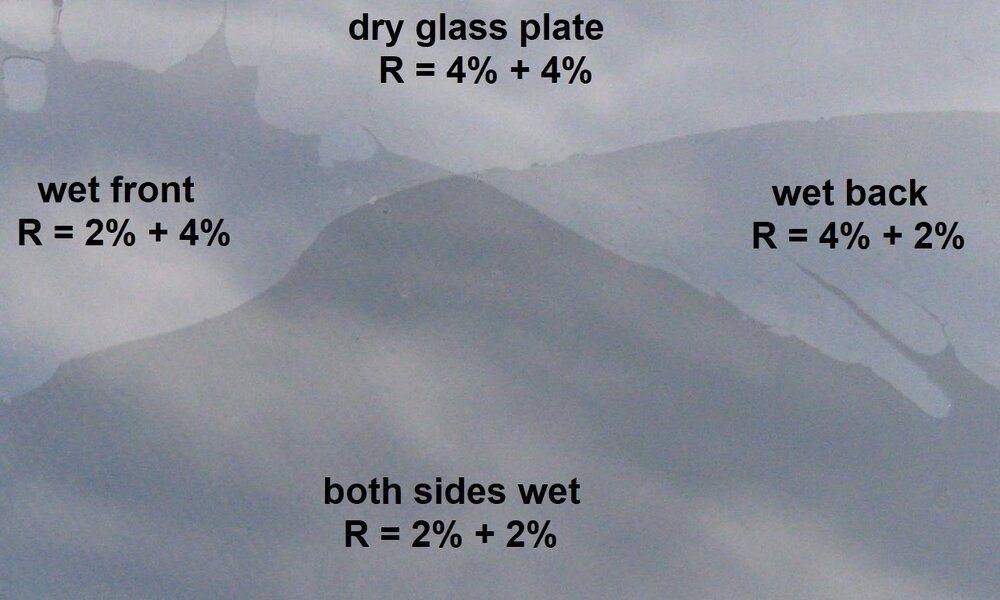

This has been touched on by a lot of people, but I think the main effect from wetting the plate is the reduction of scattering (because the water surface is much smoother).
Dry plate = high scattering and incident light from any direction can enter your eye. The result is that the plate looks bright and white-ish (color would come from either absorption or interference, which are weak effects in this case).
Wet plate = low scattering. Incident light is reflected like a mirror and only enters your eye if the angles are just right. The result is that it looks darker unless it's actually reflecting the ceiling light or something directly into your eye.
Think of wet tree trunks or the world in general after it rains. Scattering is reduced on all surfaces. The result is that they look darker, but ALSO that all the colors look richer. This is because you no longer see all the added white light from scattering, and only see the colored light after absorption of certain wavelengths in the tree trunk.
Somewhere in this thread I became more interested in simple glass surfaces than in white glazed ceramic. On glass surfaces, such as microscope slides and float glass, wet areas reflect the sky darker than dry areas. Does anyone know the typical surface roughness (in nm) of such glass surfaces? It would be interesting to compare it to the average wavelength of the light.

It is possible to see the same color rings with water. First wet the surface with soap water, let it evaporate, breathe on the surface, and see the interference colors appear. Although this foggy condensation layer is probably composed of droplets instead of a film.
Alcohol film on glass slide
I don't know why I didn't do this simple back of the envelope check earlier, but using the Fresnel equations you would expect about 3.4% reflection from a dry slide and about 2.2% reflection from a wet slide.
Assumptions: low angle of incidence so polarization doesn't matter (<10 deg), glass index 1.45, water index 1.33, no interference effects (which is valid for any film where you don't see the colors, because sun/room light has a super short coherence length)
