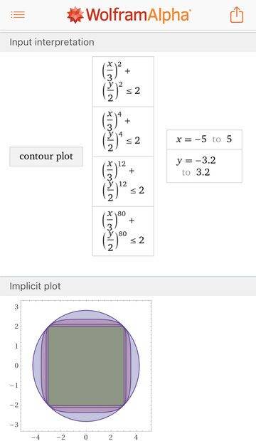

The method of bivariate induction is laid out in the article, I just want someone to check my work, I used Lagrange Multipliers to find extrema of the sequence of sets to prove they are nested but not sure if that's enough, or do I need convexity too?
Link to my insight Article it's right where I need you to start checking, read the above boxes to, check out the picture to see examples of the kind of sequence of sets we are dealing with. I need you to read the section jusr below the first picture entitled "3.0.2 Lemma 2.1: Nesting Property of ##S_N^n##".

In case you’re curious this is what the n=2 (ie 2-dimensional family of sets looks like
