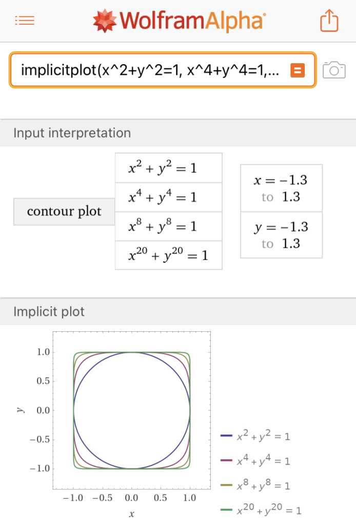

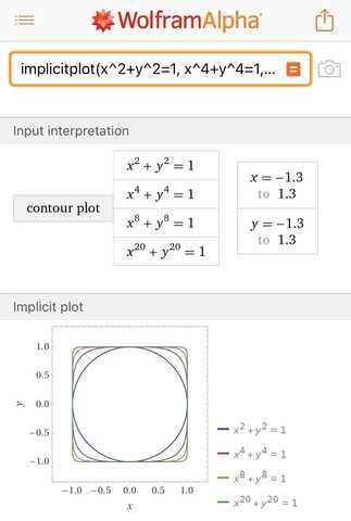

Images of the 2-d versions of the some of the sequence of sets ##S_N^2## and the geometry of the next heading’s method of finding extrema
implicit plot
A few members of the 2-d version of this sequence of sets C_N^2

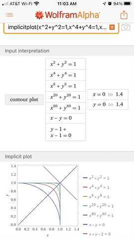

Example 2-d S_N^2 sets for extrema
$$\nabla f = \left\langle {4\tfrac{{x_1^3}}{{b_1^4}},4\tfrac{{x_2^3}}{{b_2^4}}} \right\rangle  = \lambda \left\langle {\tfrac{1}{{{b_1}}},\tfrac{1}{{{b_2}}}} \right\rangle  = \lambda \nabla g \Rightarrow \lambda  = 4{\left( {\tfrac{{{x_1}}}{{{b_1}}}} \right)^3} = 4{\left( {\tfrac{{{x_2}}}{{{b_2}}}} \right)^3} \Leftrightarrow {x_2} = \tfrac{{{b_2}}}{{{b_1}}}{x_1}$$
Plug this relation into the former inequality, namely
##f\left( {{x_1},\tfrac{{{b_2}}}{{{b_1}}}{x_1}} \right) = {\left( {\tfrac{{{x_1}}}{{{b_1}}}} \right)^4} + {\left( {\tfrac{{{x_1}}}{{{b_1}}}} \right)^4} \leq 2 \Rightarrow {\left( {\tfrac{{{x_1}}}{{{b_1}}}} \right)^2} \leq 1 = :{\max _{1 \leq i \leq 2}}\left\{ {{{\left( {\frac{{{x_i}}}{{{b_i}}}} \right)}^2}} \right\}##
where ##{\max _{1 \leq i \leq n}}\left\{ {{a_i}} \right\}: = \max \left\{ {{a_1},{a_2}, \ldots ,{a_n}} \right\}##. Checking to see if ##S_2^2 \subset S_1^2## by plugging in maximal values we get ##\sum\limits_{k = 1}^2 {{{\left( {\frac{{{x_k}}}{{{b_k}}}} \right)}^2}}  \leq 2{\max _{1 \leq i \leq 2}}\left\{ {{{\left( {\frac{{{x_i}}}{{{b_i}}}} \right)}^2}} \right\} = 2##, and hence ##S_2^2 \subset S_1^2## the base case is proven to hold.
