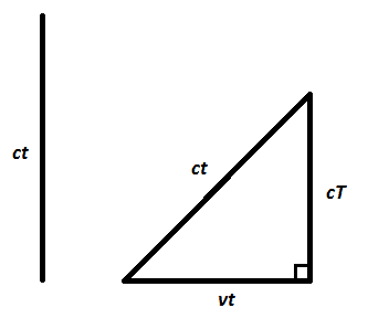

Recall the original Special Relativity thought experiment: A spaceship travels at constant velocity v, moving in the positive x direction. An observer on the spaceship emits a photon directly upwards, from the floor of his ship to the ceiling, and measures the time, call it T. To a stationary observer watching the ship fly by, the beam of light will travel in a diagonal path. If we denote the time measured by the stationary observer t, then when the ship has traveled a distance v*t, the stationary observer will see the light travel a distance c*t. This situation can be modeled with a right triangle;
If we use Pythagoras we can solve for the ratio of T/t and get the usual Lorentz Factor.

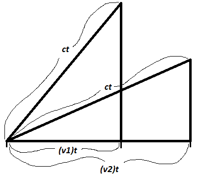

Now the question that has been bothering me: Imagine the same situation, however now we have two ships, each traveling in the same direction but with different speeds. Call the slower ship v1 and the faster ship v2. In the same time t, as measured by a stationary observer, the slower ship will travel a distance v1*t, and the faster ship will travel a distance v2*t. If each ship emits a photon at the same time, the stationary observer will see two beams of light, with the one coming from the faster ship making a smaller angle. We can model this with a pair of triangles;
From this diagram it appears that the photons, as measured by everyone involved, travel different distances in the vertical direction.
Since the ships are identical, does this mean the photon on the second ship does not make it to the ceiling at the same time the first one does? How would this discrepancy be resolved if the two moving observers were watching each other? Since there is no length contraction in the vertical direction I would expect the two photons to reach the top in the same amount of time. Does this mean an observer on one ship would see the photon of the other ship traveling slower?
According to the "stationary" observer they do not.
Each rocket measures the same time for its own photon to reach the ceiling. But they observe that the clocks used by the other observers are running slowly.
No. All observers "see" all photons as moving at the same speed.
To understand this, you'll need to consider the relativity of simultaneity.
Well, those diagrams were drawn by the stationary observer, so you can definitely conclude it's true for him.
Why? Look at the original figure you posted:
Now imagine that the stationary observer shoots a light pulse upward, and just as the ship passes it shoots its own light pulse upward.
Note that the stationary observer's light pulse travels upward a greater distance than the ship's pulse, because they spend the same amount of time traveling according to the stationary observer.

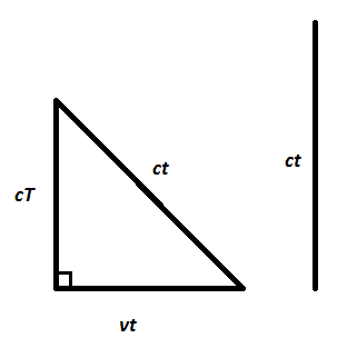

Here is what things look like to an observer at rest in the ship.
Note that the ship observer's light pulse travels upward a greater distance than the stationary observer's pulse, because they spend the same amount of time traveling according to the ship observer.
