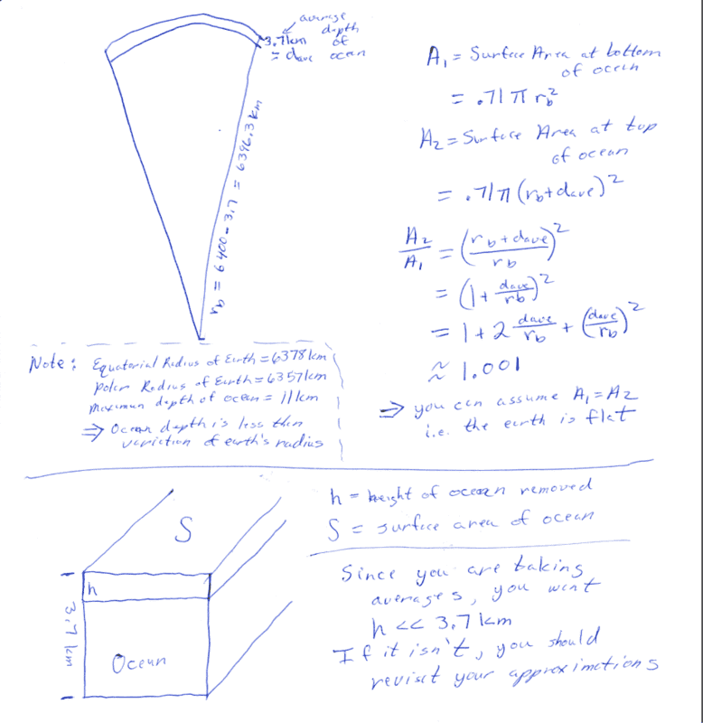

You should always make sure that you can visualize the situation. I've attached a drawing.
The top is why you can assume that the Earth is flat. Once you gain experience, you will be able to recognize these situations. Ooops. I accidentally left the 4 out of the surface area equations. Since I am taking ratios it cancels out. Sorry.
The bottom is the image of the problem to be solved under this approximation. It is independent of the shape of S.
If I assume that one glass = 200ml = 200 (cm)^3 = 2*10^-13 km^3
I get a height drop of 5.5*10^-16 mm
For 7.8 billion people it is 4.3*10^-6 mm
Fun fact: a water molecule is about .27*10^-6 mm across.
As a side note, a glass of water is roughly 100mm tall. Given that is has to be spread over the entire earth, you would expect the ocean drop to be significantly smaller than this.

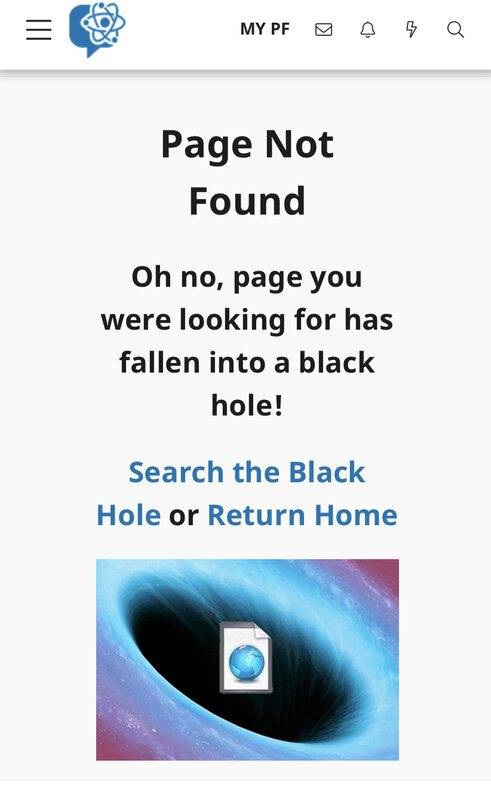

Thank you for your reply and for your brilliant diagram. How did you find the maximum depth of the ocean and the average depth of the ocean? Could you do this without researching ie. just using the information given? Also why is the surface area at the top of the ocean different to the bottom? Is the segment you have drawn representative of a wedge of the Earth?
phinds said:
HUH ?https://www.physicsforums.com/attachments/274185
When I attempt to open the link it claims page not found...

Thank you for your reply. Is there any way to substitute the ocean depth and average ocean depth algebraically then if this cannot be calculated from the information given?
Oh right, so you are referring to one sphere with a radius of the Earth and another with a radius to the ocean floor?
The ocean depth does not matter other than as a sanity check.
The first figure allows me to justify the second figure.
Look at my second figure. You are interested in calculating h. You know the volume removed V and you know the surface area S=0.71*4*pi*r^2. What is the relationship between h, V and S?
Yes.
You could calculate the initial volume of the ocean, subtract the amount removed and then calculate the change in height. The problem with doing this is that you are subtracting a small number from a big number. This can result in rounding errors and errors with significant digits. Coming up with a relationship between h,V and S avoids these difficulties.
Yes.
Ah, ok. Also how have you calculated the average depth from the maximum depth?
Moreover, where you state the surface area at the bottom of the ocean is 4*0.71*pi*rb^2 is this calculating the surface area of the Earth minus the area of the ocean?(since the depth of the ocean is subtracted from the radius of the Earth)
Then is the surface area at the top of the ocean, being 4*0.71*pi*(rb +average depth)^3 equal to the entire surface area of the Earth since this includes the depth of the ocean?
So the volume removed is 2*10^-13 km^3 and the surface area of the ocean is S=0.71*4*pi*r^2.
When referring to the relationship between h, S and V would this be that the height of the Earth is equal to 2r, so that SA=4*pi*h/2^2 and V=4/3*pi*h/2^3?
I am not sure how to relate them otherwise but I do not believe I am thinking along the right lines here.
How would I embark upon the method to calculate the initial volume of the ocean, subtract the amount removed and then calculate the change in height? Thank you again for all of your diligent help 👍
You cannot calculate the average depth from the maximum depth. There is not enough information.
Look at the second picture. You are taking a glass with volume V from the ocean. Since this will lower the ocean by a height h, you can view this volume as originally being distributed as a layer with a thickness h at the top of the ocean. The ocean has a surface area S. So V=Sh. Solving for h, gives h=V/S=200ml/(0.71*4*pi*r^2) where r=6400km.
The non-recommended way to do it. Look at the second picture. The volume of the ocean is the surface area multiplied by it’s average depth. Subtract the glass of water to get the remaining volume. Divide this by the surface area to get the new depth. Subtract this from the original depth to get the change in height. You will find that you will have round off problems if you do this numerically. If you do this analytically you will end up with h=V/S as above.
Look at the second picture. You are taking a glass with volume V from the ocean. Since this will lower the ocean by a height h, you can view this volume as originally being distributed as a layer with a thickness h at the top of the ocean. The ocean has a surface area S. So V=Sh. Solving for h, gives h=V/S.
The non-recommended way to do it. Look at the second picture. The volume of the ocean is the surface area multiplied by it’s average depth. Subtract the glass of water to get the remaining volume. Divide this by the surface area to get the new depth. Subtract this from the original depth to get the change in height. You will find that you will have round off problems.
Thank you for your reply. How did you find the average depth then?
So just to check would the surface area be 0.71*4*pi*6400^2?
Ok, attempting the non-recommended method... what value for the volume would I be subtracting 2*10^-13 km^3 from? i.e. how would I find the ocean volume using the information given. Also, is the original depth taken to be 3.7km?
Would volume of oceans be .0.71*4/3*pi*6400^3~1.22*10^8 ?
Notice that I put additional info into my response.
I googled the average depth.
Yes.
The ocean volume is its surface area multiplied by it’s average depth. The average depth is the original depth.
You need to get out of your head that you are calculating the volume of a sphere. You are calculating the volume of a thin layer which is its surface area times its thickness.
Or could we say h=V/S
Thus, h=4/3*pi*r^3/4*pi*r^2
h=4*pi*r^3/3/4*pi*r^2
h= 4*pi*r^3/12 *pi*r^2
Remove the common factor 4 and cancel pi:
h=r^3/4r^2
Apply the exponent rule:
h=r/3
Thus, when r=6400km h=6400/3=2133.3333...km ?
Yes.
Thank you for your reply. Is there any way to arrive at an algebraic solution by substituting the depth in terms of h? I think I am supposed to try to solve this without further research, although that would be far more logical in my opinion 😂
Notice that I put additional info into my previous response also.
If you do my method one, you do not need the average depth at all. The change in height equals the volume removed divided by the surface area.
For method two, the depth of the ocean ends up falling out, i.e it doesn’t matter. Try it this way. Your glass is 100 mm tall. You know that by taking a single glass of water out of the ocean, that the change in height of the ocean will be less than the glass height. Calculate the change in height of the top 100mm of the ocean. If you think about it, you will see that this is the same problem.
A third way to think about it. Your glass has a cross-sectional area equal to the surface area of the ocean. If it’s volume is 200mm, how tall is it? This is an equivalent problem.
