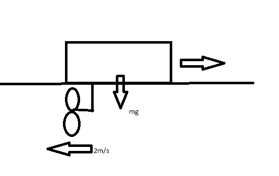

From the problem statement I expect the water pushed backwards is a cylinder with radius 7 m
Yep I did learn about the three Newton laws and momentum too.
From your statement, this means I can find the volume of water pushed per second? How does finding the volume of water pushed per second help me to find the force by any chances?
Water is pushed one way ##\Rightarrow## ship is pushed the other way (Newton too !)
Yep, but how will I be able to find out the force numerically by the speed of the water? Thanks
How much force does it take to push a volume V of water away with 2 m/s every second ?

Assume the ship lies still. Propeller turns and pushes back ##V## m3/s
What is the change of momentum of the water ? Sho what is the change of momentum of the ship ?
