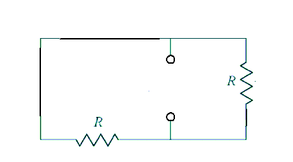

In the circuit below, V = 6 volts, R = 10 ohms, L = 100 mH. The switch has been open for a long time. Then, at time t = 0, the switch is closed.
What is the time constant for the current through the inductor?
2L / R
TAU=l/R
I am not sure how do I find the equvialent resistance in this case.
Kill the source (short the voltage supply) and remove the inductor. Find the equivalent resistance at the terminals where the inductor was.
Circuit schematic of a closed loop with two resistors labelled R, one on the bottom wire and one on the right side, and two open terminals on the top wire where an element is absent.
  • Circuit schematic of a rectangular loop with two resistors labeled R, one on the bottom wire and one on the right side, and a gap with two open terminals in the middle of the right branch.

Equvialent resistance is 2r then time constant should be L/2R?
instead of 2L/R?
Thanks
instead of 2L/R?
Thanks
Nope. Those two resistors are not in series with respect to the open terminals. So the resistance is R/2. That makes your time constant 2L/R.
