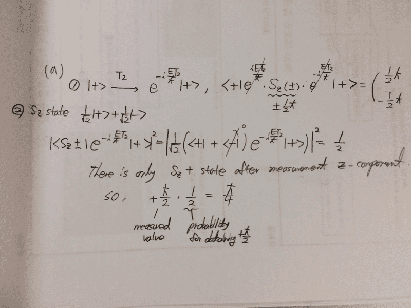

I tried to solve (a), but i don't know which approach is right ((1) or (2)) and how to solve (b).[/B]

You don't start the problem correctly. The ##|S_z = + \hbar/2 \rangle## state is not an eigenstate of the Hamiltonian, so after a time ##T_2##, the state of the system is not ##e^{-i E T_2 / \hbar} |S_z = + \hbar/2 \rangle##.

H=-(e/mc)S * B , Sz and H differ just by a multiplicative constant, so they commute. The Sz eigenstates are also energy eigenstates.
(* I tried to solve it Sz not Sx by mistake)

In which direction is the magnetic field?

In the problem, megnetic field is Bx direction.

So how can you rewrite ##\mathbf{S} \cdot \mathbf{B}##?

Sx * B
Then how can i solve this problem. i would appreciate it if you can help me
You have to express the initial state in terms of the eigenstates of the Hamiltonian.

I think it is not. Sx and H have same eigenstates, so the initial state l+> is lSx+> + lSx->
Don't forget the normalization factor.
But now that the state is expressed in terms of the eigenstates of the Hamiltonian, it should be easy to calculate the time evolution.

I think the answer is weird. These are the probability for Sz + , and 1-cos(T2/h)(E1-E2) for Sz -
So, the expectation value h/2(1+cos(T2/h)(E1-E2)) and -h/2(1-cos(T2/h)(E1-E2)) respectively

Why? This is a very standard problem in QM and illustrates nicely the concept of precession.

Ok, I had replied before you posted the solution.
There is a problem, as you can clearly see that the prbability you get ranges from 0 to 2. Check again how you calculate the absolute value squared.

I got it, then how can i approach problem(b) i think the result of first measurement is same with (a)

The probability of measuring Sz = +ħ/2 is indeed given by the same equation, replacing T2 by T1. But you already know the measurement result, so you need to figure out what you get at T2.
By the way, you can simplify the result you get using explicit values for E1 and E2.

Result of first measurement at T1 is the same with (a). I should have to get a probability of that state before i get a expectation value as i did in (a).
I think total result probability is probability(T1) * probability(T2)
Answer is quite complex, is it right??
