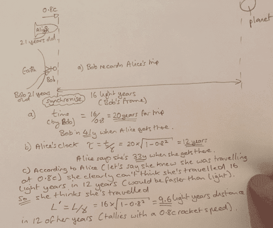

Bob and Alice are both 21. I'm imagining a scenario where Alice starts on a journey at 0.8c towards a distant planet.
Bob (stays still) says this planet is 16 light years away and that it takes Alice 16/0.8 = 20 years to get there (so Bob is 41 years old when Alice gets there). So Bob says journey time t = 20 years
Alice, traveling at 0.8c. So according to her time, t0 = t x √(1-0.8^2) = 12 years
(So Bob's registered time is dilated compared to hers).
Now (I think this is right!), as Alice is traveling at 0.8c clearly can't travel 16 light years in 12 years (from her clock) so that she thinks she has only traveled L0 = L x √(1-0.8^2 = 9.6 light years, so she says "of course it only took me 12 years because I only had to travel 9.6 light years."
I drew this out on paper below and it feels right to me ..(please assist if I'm already confused)
This would be confirmed (would it not) if Alice fired a laser pulse at time zero that she records takes 9.6 years to traverse the 9.6 light years (from her perspective) but Bob who also sees the laser pulse records that it takes 16 years to traverse the 16 light years distance?
All OK with my thinking?

Your maths is fine, but you seem to be missing a few concepts.
How do Bob and Alice confirm that they are both 21? And if Alice sends a laser pulse to Bob, how does she determine when it arrived?

The problem here is that there is no such thing as "a clock of hers on that planet running at the same rate as her clock". If it's on the planet it's moving relative to her, so it's not running at the same rate as her clock.
It is possible to work out when the pulse arrived using just Alice's clock, the one in her spaceship, and it's well worth the effort of figuring out how yourself. Two hints:
1) assume a mirror on the planet, so any signal Alice sends ahead will be reflected back to her.
2) think about the situation as if Alice is at rest and the planet is approaching her.

It is less intuitive to you because your intuition here is wrong... and I suggested it because I suspected from the way you worded your first two posts that your intuition was still misleading you.
In particular, the confirmation you came up with in the first post: "This would be confirmed (would it not) if Alice fired a laser pulse at time zero that she records takes 9.6 years to traverse the 9.6 light years (from her perspective)" is intuitive but misleading. The speed of light is ##c## in all frames, so if Alice emits a flash of light and then waits 9.6 years, the flash of light is going to be 9.6 light-years in front of her. If the planet and Alice were 9.6 light-years apart when the flash was emitted, and the distance between Alice and the planet is getting smaller as they approach one another, the flash of light has to reach the planet in some time less than 9.6 years.
And here is the easy way to work it out, using just Alice's clock. Alice emits the flash of light at time zero. The reflection comes back to her at time ##T##. Because we're using the frame in which Alice is at rest, we know that the light hit the mirror at time ##T/2## - the distances traveled by the outgoing and the return pulse are the same in this frame, ##T/2## light-years out and ##T/2## light-years back. The fact that the mirror/planet was moving is irrelevant; all that matters is where the mirror was at the moment that the light reflected from it. Note also that we don't need Bob, or Bob's numbers, or Bob's observations... Alice is perfectly capable of setting her clock to zero at the moment that the planet is 9.6 light years away from her without any help from Bob.
For this particular example (planet/mirror is 9.6 light years away when the flash is emitted, relative velocity of planet/mirror and Alice is .8c), it turns out that ##T## is 32/3 years, ##T/2## is 16/3 years, the flash of light reaches the mirror when it is about 5.3 light-years from Alice and 5.3 years have passed for her.
(This might be a good time to mention the relativity of simultaneity. In Bob's frame, the events "light hits mirror" and "Bob's clock reads ten years" happen at the same time - that's what it means to say that the light hits the mirror after ten of Bob's years. In Alice's frame the "light hits mirror" event happens at the same time as the event "Alice's clock reads 5.3 years". However, it does not follow that the events "Bob's clock reads ten years" and "Alice's clock reads 5.3 years" are simultaneous in either frame - they are not.)
