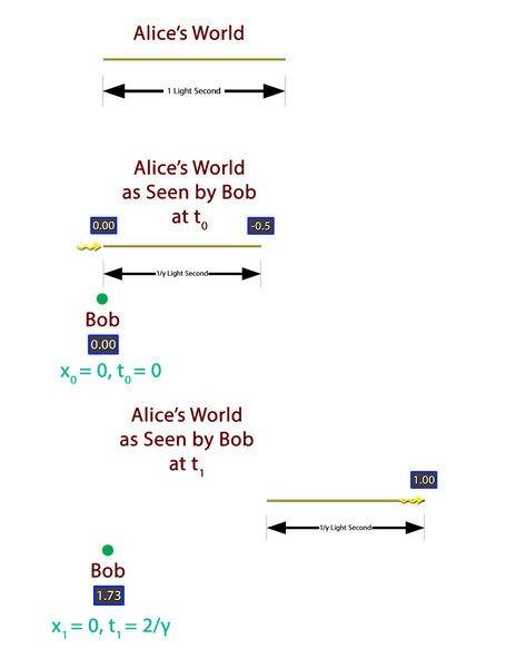

Thanks to everyone who has helped! SlowThinker, I appreciate your taking the time to step through the calculations.
After a lot of noise, I have to say my original calculations were off by .5 seconds. Having the exit clock off by -0.5 (from Bob's point of view), fixes it.

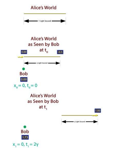

Rather late to the game, I'll add a diagram of the problem. Assume the clocks are synchronized (from Alice's point of view) and run continuously. It is just an accident (or careful planning) that the entry clock reads zero when it passes by Bob and the light burst enters. The exit clock doesn't stop, but Bob notes the reading as the light exits.
Timing and positions from Alice's point of view aren't included (except the clock, of course). We can say that at the Bob's t0, x'0 = 0 and t'0 =0. At exit, x'1 = 1, t'1 = 1, assuming I got it all correct (which, I realize) is a big assumption.
@robphy: You may be right about the spacetime diagrams, but (crazy me), I actually wanted to see the numbers work out. And I learned something by trying to calculate the numbers that I might not have picked up on with all those diagrams. Personally, I'd close this thread and consider it done, but I wouldn't mind hearing if there are errors on the diagram.

Actually, if you open the spreadsheet and use View Formulas, you'll see the equations as equations. Some of the variables have an underscore in front of them to keep Excel happy (e.g. v/x looks like _v/_x).
But SlowThinker has cranked through it all for me and showed me how to fix the 0.5 seconds too much I was getting, so no need to bother. Thanks.

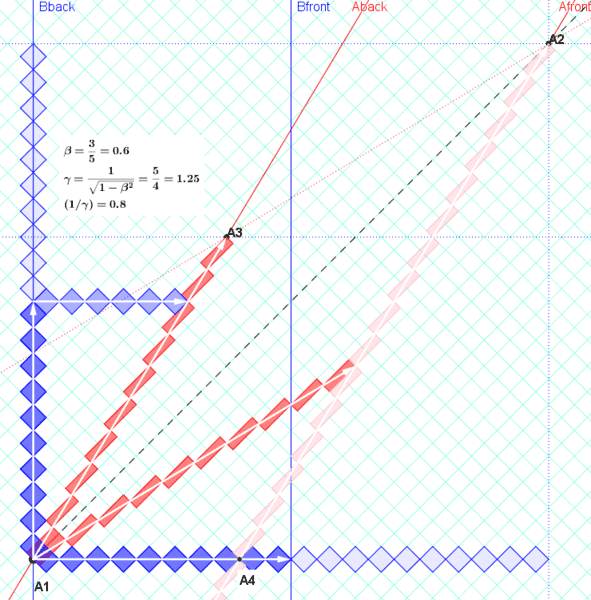

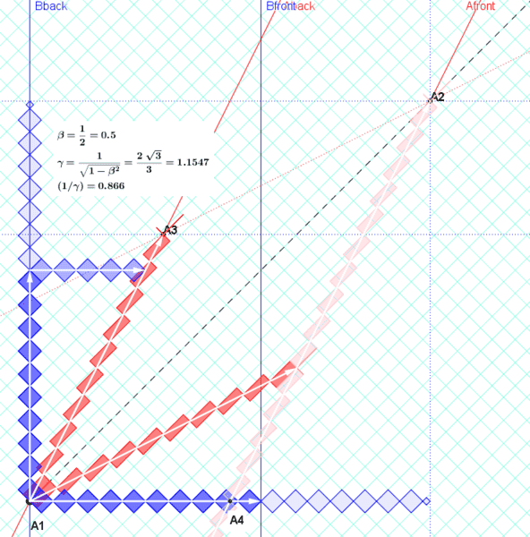

robphy said:
Numerical calculations are so much easier
if v=(3/5)c (so gamma=5/4, Doppler=2)
This is my preference. I always use v = 0.6 c. It is easier to draw accurate spacetime diagrams than larger values.
Alice's track should be 1/##\gamma## long with the correct definition of ##\gamma## (##\gamma\geq 1##). Bob sees Alice's track shortened.
Also Bob's ##t_1## is correctly 1.732 but that's 2/##\gamma## not 2##\gamma##.
I'm not sure if it's just a mistake or some deeper misunderstanding.
No, that's me making one of my stupid mistakes. I've been correctly contracting the length and calculating t1 using numbers and not symbols. As I am new to this, I got it in my head when doing the diagram that .866... was ##\gamma##. My spreadsheet correctly uses 1/##\gamma## for length contraction. Once I got the first one wrong, Bob's t1 came along for the ride.
If those are the only errors, I'm happy. I hate to leave the wrong diagram up--I'll see if I can fix it and edit the post.
Thanks so much!
PeterDonis said:
It looks like @SlowThinker has already given a solution that satisfies you, but I'm going to go ahead and work it the way I would work this type of problem. Actually I'll work it two ways.
Thanks, PeterDonis! I appreciate all your time and effort.I apologize for any frustration you may have experienced.
I'll give a couple of examples of things you might find clear and that confused me: In your reply for example, you consider A2 and A3 as "events" even though, if people associate a location with an event, it is the location at which the event occurred. In physics perhaps you define it differently. Event A3 seems completely irrelevant anyway and I'm still scratching my head as to why it's there. Why do you give Bob's values as A1, A2 and A2 instead of B1, B2 and B3 (or: "why is there an 'A' prefix at all?"). This particular reply was detailed enough that I could figure out what you meant, but sometimes people provide answers with embedded assumptions and not enough detail to decode.
Among responses, "Go study the relativity of simultaneity" is a correct, but unproductive answer. "Use the Lorentz transform" misses the entire point since I was trying to cross-check the transform. Using it (properly) gives the correct answer, but without any insight. "You forgot to account for the fact that the entry and exit clocks don't appear synchronized to Bob" provides the insight and completely answers my question. It doesn't even require that many words. Credit goes to PeroK--we should put a gold star next to his reply. SlowThinker's calculations were icing on the cake since I was interested in cross-checking numbers and that was what he did.
I'm sure I phrased my question poorly. Putting up a diagram at the start would have been better. That PeroK was able to decipher my question and address the key point succinctly is amazing.
I don't seem to be able to edit my response with the diagram, so here's the corrected diagram.

To summarize @PeterDonis 's careful analysis of your original problem,
( https://www.physicsforums.com/threa...vers-in-two-frames.952195/page-2#post-6032350 )
here's a spacetime diagram on rotated graph paper
(for the case of ##\beta=3/5##, which leads to easier arithmetic... then for the case of ##\beta=1/2##).
By the way, ##\gamma(1+\beta)=\sqrt{\frac{1+\beta}{1-\beta}}=k## (the Doppler Factor).
For ##\beta=3/5##, we have ##k=2##.
For ##\beta=1/2##, we have ##k=\sqrt{3}\approx 1.73205##.
In my rotated graph paper diagrams,
the "light-clock diamonds" (the "ticks") have the same area
and the "aspect-ratio"="width"/"height"=##k^2## (which is easier to see for ##\beta=3/5##).
