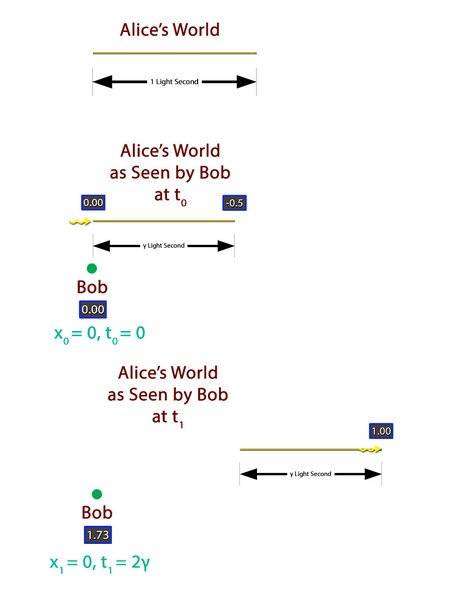

I am not a physicist—not even close—just a guy who, for some crazy reason, decided to try to understand some of the basics of relativity. I’d like to understand them well enough to be able to explain them (correctly) to another lay person. I’m trying to see how much I could explain without relying on complex math formulas or those lovely diagrams with tilted space axes.
There are a gazillion tutorials and references about relativity on the web, but sometimes I have a question that all these seem to avoid or gloss over.
Let me introduce Bob and Alice, who are in different inertial frames. Bob sees Alice as moving away from him at ½ c. Alice would say the same about Bob. Both Bob and Alice have a light speed measurement device: a track, 1 light second (LS) long, with synchronized clocks on both ends that record when a light pulse passes by. The tracks are aligned along the axis of motion.
Based on the theory of relativity (and a lot of experiments), we know that both devices will time the pulse at exactly 1 LS/sec. This remains true even if Bob originates the pulse and has it travel through his track before reaching Alice and her track.
That’s how each sees their own track measurement. But how does Bob see Alice’s measurement?
My premise, and what I see implied in various articles, is that time dilation and length contraction allow each observer to see their own measurement at 1 LS/sec, while they also see the other’s measurement at 1 LS/sec, even though classical physics would say that the “moving” object should measure light at ½ LS/sec (since the object is moving at ½ c).
I thought I would test my understand by checking the numbers. I went to http://hyperphysics.phy-astr.gsu.edu/hbase/Relativ/tdil.html to use their handy calculators for time dilation and length contraction. For Bob, Alice’s track is only 0.8660254037844386 LS long. Alice is moving at ½ c, so from Bob’s point of view, a light pulse traveling down Alice’s track will take twice the time it would if the track weren’t moving.
Bob will see that the pulse travels 2*0.866… in 2*0.866… seconds, of course. Bob understands that Alice may view herself as the one who is not moving and that she perceives her track as 1 LS long. So, to my naïve way of thinking about it, time dilation will convert Bob’s 2 * 0.866… seconds into Alice’s 1 second and everyone will be happy—no matter how you measure it, light travels at c.
The time dilation is the inverse of the length contraction, but we are going to convert from Bob’s frame to Alices’, so diving by the inverse is the same as multiplying by the original number. Even without doing the math, I can sense trouble. The equation looks like 2 * 0.866… * 0.866… or 3 * 0.866, which is clearly not even close to 1 second.
What factor did I fail to take into account or what concept did I get wrong?

You left out relativity of simultaneity. Bob's and Alice's clocks are not synchronized the same way. If you are going to use time dilation and length contraction to do your calculations, you also have to take relativity of simultaneity into account; otherwise you will get wrong answers.
A simpler way to get the right answer is to not even think about time dilation and length contraction, but only about coordinates and Lorentz transformations. Assign coordinates to all of the relevant events in Bob's frame, then use the Lorentz transformation to obtain the coordinates of those same events in Alice's frame. Once you have the coordinates in a given frame, you can compute speeds in that frame using those coordinates.
Based on your scenario, here are the key events that I think you will need to assign coordinates to:
Origin: This is the event that has coordinates ##(x, t) = (0, 0)## in both frames. Usually it is taken to be the event at which the two observers (Bob and Alice in this case) pass each other. The implication is that at the instant they pass each other, they both set their clocks to read the same time, which is called time ##0##.
B1: The event at which the light pulse passes the left edge of Bob's track.
B2: The event at which the light pulse passes the right edge of Bob's track.
A1: The event at which the light pulse passes the left edge of Alice's track.
A2: The event at which the light pulse passes the right edge of Alice's track.
The speed of light in Bob's frame will then be the rest length of Bob's track, divided by the time elapsed, in his frame, from B1 to B2. Similarly, the speed of light in Alice's frame will be the rest length of Alice's track, divided by the time elapsed, in her frame, from A1 to A2. Those are the two speeds that should come out to 1 (and which correspond to the speeds shown on the digital readouts of the two measuring devices).
Note that it is *not* going to be the case that the moving length of Alice's track in Bob's frame, divided by the elapsed time in Bob's frame from A1 to A2, will give 1. Nor will the corresponding "moving" calculation give 1 for Bob's track in Alice's frame.
Once you have the above coordinates and speeds calculated, it should be easier to see how time dilation, length contraction, and relativity of simultaneity come into play.

Bear with me for a short while longer.
Alice measures a light pulse through her track. It takes 1 second.
Bob measures a light pulse through Alice's track. It may not be the same light pulse at all. He observes that light travels 2*0.8660254037844386 light seconds in 2*0.8660254037844386 seconds. Great! c is c everywhere. Now, Bob wants to convert his time measurement into what he perceives Alice experiencing (he views her clock as running slower). So he divides his time by the time dilation factor of 1.1547005383792515 and gets 1.5 seconds. I was really hoping Bob would get 1 second. Bob thinks Alice sees light traveling slower than c.
Let's work it out by events as it may more clearly reveal my problem. Alice and Bob coordinate their clocks as they pass each other. The time reads 0. A pulse of light enters Alice's track at time 0. This is PeterDonis's A1 event.
We do not care about Bob's track, we only care about Alice's, as observed by both Bob and Alice. Events B1 and B2 are irrelevant.
At time 2*0.866..., Bob see's the pulse exit Alice's track, event A2. Alice sees the same event at time 1. I would be tempted to say that the time dilation is 1/(2*0.866...) which is 1.732050807568877. But the time dilation formula says 1.1547005383792515. Using the correct time dilation, Alice's clock reads 1.5 seconds when Bob sees the light pulse emerge from her track.
Issues related to simultaneity may provide the answer, but I need the dots connected a little more directly than just making that statement. I've gone through a ton of articles and tutorials, but most of them do what PeterDonis was trying to do: connect A events with B events. I even found one article that said basically that my calculations should lead to the result I expect, but didn't actually bother doing the calculations.
Maybe I don't know the point of time dilation. I thought it was to map the clock in one frame of reference to another. If Bob maps the pulse time to 1.5 seconds, but for Alice, the pulse exited half a second earlier, then what's the point of the mapping?
Let me try another way: Alice sends a video of the light pulse measurement to Bob. Bob receives the video and corrects it for the increasing light delay. He should see the clock start at 0 and stop at 1 and, if the time dilation factor is correct, he should measure this as taking 1.154... seconds. Being a physicist, he doesn't need to actually look at Alice's track--he just calculates the length compression, factors in the speed at which the track is moving and comes up with 1.7320... The numbers don't match.
Once again, since I'm prone to adding 2+2 to get 22, don't assume any of my calculations are actually correct. The time dilation factors come directly from the website I referenced (using cut/paste), but I wouldn't just accept those, either.
Thanks for your patience.
Nope. Again, you are ignoring relativity of simultaneity.
I strongly suggest that you take the suggestion I gave in my previous post, and work this problem using coordinates and Lorentz transformations first, and then, once you've got the right answer that way, go back and figure out how time dilation and length contraction fit in.
To give you a hint, consider the events A1 and A2 that I described in my previous post, that correspond to the light signal passing the left and right ends of Alice's track (I'm assuming the light is traveling left to right). The time elapsed in Bob's frame between those two events is some time ##T##. (I know you've calculated the numerical value of ##T##, but that's actually a red herring; you can work the problem and get the speed of light in both frames without ever actually calculating this value!) So if we assume that event A1 is also the origin of coordinates (which implies that Bob and Alice pass each other right at that same point in space at that same instant), then we can assign coordinates ##(0, 0)## to A1 and coordinates ##(T, T)## to A2, since we know the light pulse travels at speed ##1## in Bob's frame.
Now, consider another event which I'll call A3. This event is the event on Alice's worldline that happens at the same time as event A2. So the time it takes for the light pulse to traverse Alice's track will be the time between events A1 [edit: corrected from A2] and A3. But of course I left out a key qualifier: the time in which frame? We are looking for the time in Alice's frame, right? But that means we also have to use the definition of simultaneity for Alice's frame! In other words, which event on Alice's worldline happens "at the same time" as A2 depends on which frame you choose; to properly pick out event A3, we need to use the definition of "at the same time" in Alice's frame. And that is different from the definition of "at the same time" in Bob's frame, which is the simultaneity convention you have (without realizing it) implicitly been using in your calculations based on time dilation.
The great advantage of the coordinates/Lorentz transformation method is that you don't have to keep track of any of this; everything automatically falls into place because of the way the Lorentz transformation works. That is why I am again strongly suggesting that you try working the problem using that method first, before trying to understand how time dilation fits into the picture.

PeterDonis, I appreciate your time. I went to the page I referenced and found a link to the Lorentz transformation (http://hyperphysics.phy-astr.gsu.edu/hbase/Relativ/ltrans.html). As I was setting things up, I ran the square root of .5 through my calculator. Hmmm... The length contraction formula on http://hyperphysics.phy-astr.gsu.edu/hbase/Relativ/tdil.html says that the contraction for an object moving at .5c should be the square root of .5 or .707106... But the calculator, and the value I was using, says .866...
If I use sqrt(.5)*2 light seconds for the length of Alice's track as Bob observes it (both contracted and moving at .5c), then that is also the seconds it takes for a pulse to pass through. Using the time dilation formula, to go from Bob's time to Alice's, I need to divide by 1/sqrt(.5) which just happens to equal 2*sqrt(.5) and I get 1 second.
So now it all seems to work exactly as I expected, but perhaps not how you expected. The web page calculators are the source of the error--I just figured it was me!
Just to check, the formula I used for length contraction is L = L0 * sqrt(1 - v2/c2) = 1 light second * sqrt(1 - .5c2/c2) = sqrt(.5) light seconds. The time dilation is the inverse.
I keep thinking it can't be this easy.
I got a little nervous, so I tried a different speed, .9c. The length of Alice's track becomes .3162277... light seconds. Because she's moving at .9c, it takes the burst 10*.316227 seconds to traverse the track. The inverse of .3162277 just happens to be 3.162277..., so again, we get 1 second.

I was reviewing some simultaneity examples. My favorite is the car driven at high speed into a garage (see https://www.physicsforums.com/threads/car-garage-paradox.283377/). There are light beams traveling towards the end of trains, distant explosions, etc. These all seem to have one observer who thinks two events occur simultaneously and one who thinks otherwise.
My case seems different to me. Everything I care about if from Bob's point of view. There are no arguments about whose clock is slower or whose lengths are contracted. Alice is passive. She is observed but does not get to observe. Her thoughts and opinions are not solicited. She doesn't get to decide when an event occurs--Bob will look at her track and her clock and make up his own mind. I don't think any simultaneity issues come into play.
Consider:
Bob sets up a powerful telescope to record the light pulse entering and exiting Alice's track. Alice also places a big clock right by the track exit and the telescope can resolve the numbers on it. Bob corrects the video for light delay, so he can play it back in "real time".
We have now set up a continuous mapping of Bob's world to Alice's world as seen by Bob. Again, we do not care at all about what Alice sees during any of this. A transformation is an equation that maps something from one reference to another. Bob can use the video to calculate how much slower he perceives her clock running. The time dilation calculation that Bob gets if my numbers are correct are different from what he gets if he uses the Lorentz time dilation transformation.
As we have seen, the likelihood that the Lorentz transformation is wrong is 0. The odds that I have miscalculated Bob's timing of the traversal is high. Honestly, I think that's where the problem lies and not in any simultaneity issues.
To Bob, Alice's clocks are out of sync. Assume Alice has two clocks, one at either end of the track, and has synchronised them in her frame, so that she can measure the time the pulse is sent from one end and received at the other.
To make up some numbers:
In Bob's frame, when the clock at one end of the track reads ##0s##, the clock at the other end reads, say, ##-1s##. Let's assume the pulse starts at the clock reading ##0s## and takes ##5s## in Bob's frame to reach the other end. Alice's clocks are time dilated in Bob's frames and, say, only advance ##4s## during this experiment.
When the pulse reaches the second clock, Alice's clocks read ##4s## and ##3s##. Therefore, in this case, Alice records
only ##3s## for the journey. Not the ##4s## that you are insisting on.
One of the standard texts on SR (by Morin) actually starts with the relativity of simultaneity. He derives this before he derives time dilation or length contraction. It seems to me that this is a good idea, as it hopefully prevents students from persisting with the "relativity is time dilation and length contraction and I don't think I need to bother about simultaneity issues".
That said, as others have noted, you do appear to be particularly stubborn in this matter.

That said, this is the first reply that actually provides me with some insight on where simultaneity raises its evil head. Yes, I've been assuming one master clock for both of ends of this rather long track. I can sync Bob's clock with the time at the start of the track or with the time at the end of the track. Each clock runs slow to Bob and by the same amount, but if Bob looks at both, they don't appear to agree with each other. Alice would disagree with Bob.
Got it. Thanks! Now to run the numbers...

The systematic approach is to use Lorentz transformation. If you take it for granted, good. It can be enlightening to derive it yourself, but you can do it another time.
I've tried to do that, but can't say I'm happy with the results.
Lets assign coordinates to the events B1, B2, A1, A2 in Bob's frame. Use shortcut ##\gamma##=0.866
B1: x=0, t=0
B0: x=1, t=0.5 (end of Bob's track when Alice sees the pulse to start)
BE: x=1, t=0 (end of Bob's track when Bob sees the pulse start)
B2: x=1, t=1
A1: x=X, t=T where X is the distance between the ships, of little relevance, and T=X
A2: x=X+2/##\gamma##, t=T+2/##\gamma## (I found these backwards to get 1 second in Alice's frame, 2/##\gamma##=8##\gamma##/3=2.309)
Now let's plug these into Lorentz transformation with v=0.5c: x:=##\gamma##(x-vt), t:=##\gamma##(t-vx) to get to Alice's frame.
B1: x=##\gamma##(0-0.5*0)=0, t=##\gamma##(0-0.5*0)=0
B0: x=##\gamma##(1-0.5*0.5)=3##\gamma##/4, t=##\gamma##(0.5-0.5*1)=0
BE: x=##\gamma##(1-0.5*0)=##\gamma##, t=##\gamma##(0-0.5*1)=-##\gamma##/2
B2: x=##\gamma##(1-0.5*1)=##\gamma##/2, t=##\gamma##(1-0.5*1)=##\gamma##/2
A1: x=##\gamma##(X-0.5*T)=##\gamma##X/2, t=##\gamma##(T-0.5*X)=##\gamma##T/2
A2: x=##\gamma##(X+2/##\gamma##-0.5(T+2/##\gamma##))=##\gamma##(X/2+1/##\gamma##)=##\gamma##X/2+1
t=##\gamma##(T+2/##\gamma##-0.5(X+2/##\gamma##))=##\gamma##(T/2+1/##\gamma##)=##\gamma##T/2+1
I'd appreciate if someone could check it, because between B1 and B0 I'm getting length contraction of 3##\gamma##/4=9/(16##\gamma##)=0.650 as seen by Alice.
Also Bob's clocks tick 1s between BE and B2 while Alice sees it as ##\gamma## seconds, i.e. she sees Bob's clocks tick faster than hers.
I've been looking at these results for some hours now but still can't find a mistake. Using v=-0.5 rather than 0.5 didn't seem to help.
It could make the calculations a bit simpler if we agree to set B2=A1=(0,0) i.e. X=T=0 from now on.
B1: x=0, t=0

Freixas said:
I know whatever problem you are trying to solve is not the one I posed.
Well I did my best to analyze the problem exactly as you described it.
Perhaps it's time to show us your spreadsheet.
Freixas said:
and Alice left on a much needed vacation to Tahiti (after launching "her" track, which is completely automated and has no observers or observation devices,
Umm, so what is there to reconcile then? I thought the whole point of the thread was that you were having trouble “Reconciling two observers in two frames”. With that gone I am not getting what you want to understand.
Appreciate it! I am trying to add a correction for what people have pointed out. Let's say Bob's and Alice's clocks sync when the entry end of track passes by Bob. The exit end would have passed by Bob some time ago.
Alice thinks the clocks on both ends of her track are perfectly sync'ed (she made sure before she left for Tahiti). Bob doesn't see things that way: the exit clock is off by some amount. The exit end is 1 light second away and the track is moving at .5c. What is the time discrepancy that Bob see's on the exit clock relative to the entry clock?
Anyway, that is what I trying to figure out now.
