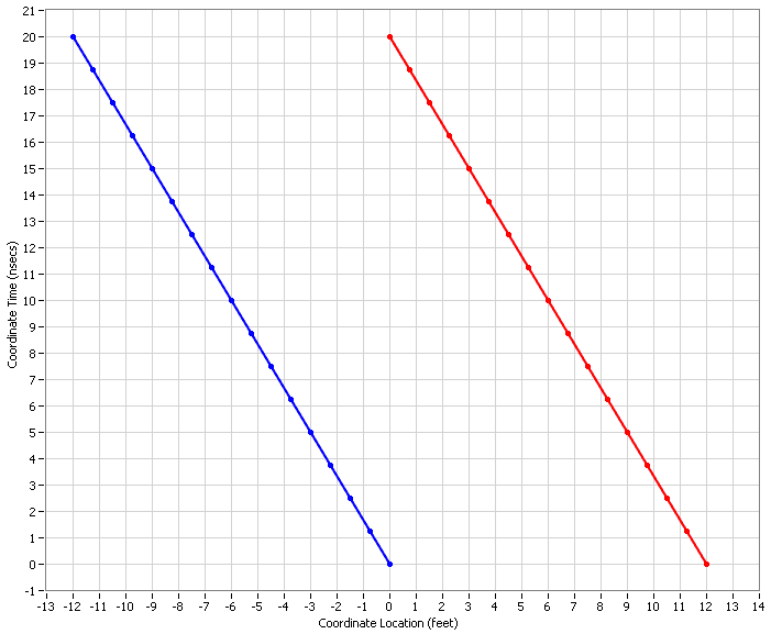

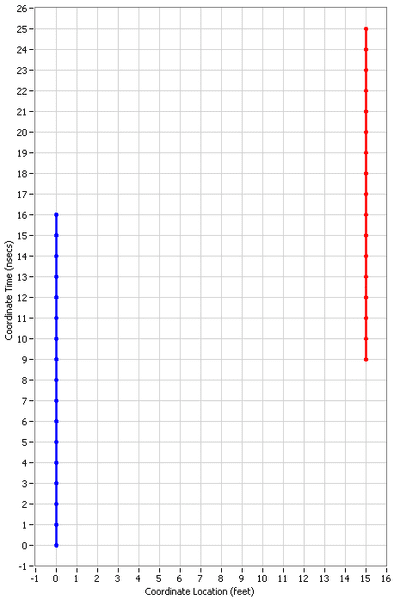

I don't understand how you can make these two things work. Here is a spacetime diagram showing the two ends of a rod of 15 feet. I offset them like that just so that the next diagram wouldn't be so large that it wouldn't fit on the page. The dots mark off 1 nanosecond increments of Proper Time for both ends of the rod. I'm defining the speed of light to be 1 foot per nanosecond:
Now I transform to a speed of 0.6c (so that the rod is moving to the left):
This shows the length contraction of the rod from 15 feet to 12 feet and if I divide that by 0.6 feet per nanosecond, I get 20 nanoseconds which is simply the time it takes for the end of the rod to traverse 12 feet at 0.6c but I don't see anything relating to time dilation as indicated by the dots on either end of the rod.
And I have no idea what you have in mind for the other calculation where you multiply the dilated time interval (where is that on the diagram?) by the velocity to get the contracted length.
Please explain exactly how your two formulas work.

It was a question of IF that would work, not a declaration that it would work.
And after playing with the equations I did see that it would not work.
