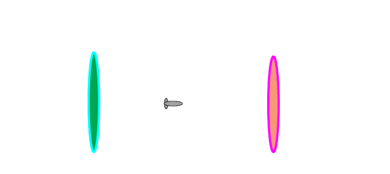

To add a bit to what already has been said: While you, in your frame of reference, will not age any slower, It will take less time by your clock to reach that planet than it would according to someone on Earth. Let's say that you are moving at 99.99% of c relative to the Earth and this distant planet. According to the Earth, you will take just a smidge over 40 yrs to reach the planet, while aging only a bit over 0.57 years. You will also agree that you aged 0.57 years, but not because you aged slower. There is another aspect of Relativity besides time dilation in play: length contraction. Because both Earth and the planet are moving at 99.99% of c relative to you, they, and the distance between them undergo length contraction as measured from your frame of reference. As a result, the distance between them is only 0.57 light years according to your measurement, which only takes 0.57 years to cross at 99.99% of c.
… which is what Earth and the planet are doing in the traveller’s rest frame. Obviously, the traveller is at rest in this frame and therefore not moving.
[Oops. What he said...]
And the observer in the travelling spaceship will measure the distance from Earth to the target planet to be much less than 40 light years. .57 light years, in fact - which is why he can get there in such a short time.
Furthermore, he will observe everything (on average) to be greatly compressed in the direction parallel to his path - including the diameter of the target planet and Earth, both of which will appear like compressed discs - 8000 miles wide but less than 100 miles (1/(40/.57)ths of 8000) thick - the former hurtling flat-face-on toward him, and the latter hurtling flat-face-on away from him.
