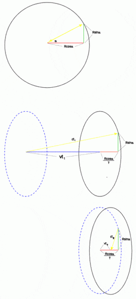

Janus said:
The thing to remember is that according to a frame in which this arrangement is moving with respect to, the Mirror will not be a sphere, instead, it will be an oblate spheroid with its short dimension laying along the line of motion. It you now calculated how long it takes for the light emitted from the center to return to the center as measured in this frame, you will get the same answer no matter what direction you fired the light. (I actually proved this mathematically for the above individual, but will not repeat it here as it takes a long series of steps).
Janus, this is the kind of argument I have been looking for my first question. Could you please provide me with your mathematical proof? Not because I'm still not convinced, but because I would like to use your proof as a "lemma" to complete the mathematical proof of time dilation on my homepage. If you do not like the idea to repeat all steps in this thread, please send it to me in a bilateral conversation. Note: Understanding length contraction in the direction of motion is no problem for me. I'm only having problems with understanding time dilation in "any direction" of movement in relation to the observer.
Here's the basic proof. assume the initial light emitted is emitted at an angle alpha with respect to the line of relative motion, The top image below shows the light traveling out to a radius of R and returning, for anyone at east with respect to the circle, the time for the round trip is 2R/c. The red and green line show the horizontal and vertical components of the light's path.
Now consider the outbound path of the light as seen by someone for which the circle is moving from left to right a velocity v(second image). The light is emitted but it has to chase after the circle. The circle is also length contracted to an oval by a factor of 1/gamma. The dotted line oval represents the location of the oval at emission, and the solid line one its position upon reaching the edge. If t1 is the time it takes for the light to reach the edge of the circle, then vt1 is the distance traveled by the oval and vt1+ R cos(alpha)/gamma is the horizontal component of the light's path. The vertical component is the same as was measured in the rest frame of the circle. The distance ct1 is the distance the light travels. From the above, we can solve for t1
Lastly we consider the return or reflected path(third image). Now the center of the oval (the light source) is rushing towards the reflected light. Now the horizontal component is the difference between Rcos(alpha) and vt2. Again, with this information you can find t2.
t1+t2 is the total time for the round trip.
If you do the math above, you will find that 2Rc will differ from t1+t2 by the Lorentz factor. The angle alpha makes no difference.
Likes Battlemage! and bookofproofs
This is sublime, thank you.
