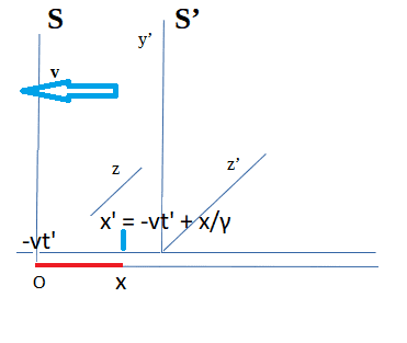

For a visualization, I modified the scenario from posting #59. Now, a red rod is at rest with respect to the "moving" frame ##S## (and length-contracted with respect to frame ##S'##).
If you solve the shown equation for ##x##, then you get the equation you ask for.

I noticed in the first picture the origin of the primed frame is vt relative to the unprimed frame, this made some sense to me.
In the second image you linked you show the origin of the unprimed frame relative to the primed frame is -vt' (minus v t primed)
If two frames are moving relative to each other then one frame will measure the origin of the "other" as vt, and if you switch which frames you are using you will measure the origin of the "other" as -vt, bur you have -vt' (minus v t primed)
Why would you use the unprimed time over the primed time or the primed time over the unprimed time?
If a primed frame is in relative motion to an unprimed frame do you use the primed time to describe the motion or the unprimed time?
Thanks in advance for any input.
  • #68
Chenkel said:
