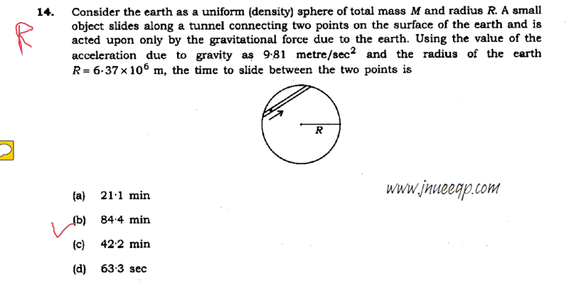

The thing to remember is that inside the Earth surface, the gravitational field does not remain inversely proportional to ##r^2##.
The equation of motion is
## \ddot r = \frac { -gr} R## ....(1)
This means that the particle will oscillate between the two points on the surface with angular frquency ## \omega = \sqrt{ \frac { g} R}##. ...(2)
## T= \frac { 2\pi } {\omega }##...(3)
The required time is ## \frac { T} 2 = 42.3 ~ min##...(4)
Hence, the correct option is (c).
The time taken for going from one point to another point of the Earth surface is independent of the distance between the two points.
Then, when I go into an underground room, I need to move for going from one point to another. Is it because of friction force?

If the tunnel was thru the centre, then that formula comes out immediately. How do you justify the SHM for a tunnel near the surface?
Otherwise, what's your question?
I don't know about which formula are you talking?

I din't assume that the tunnel is passing through the center.
Even for the tunnel not passing through the center, I think the eqn (1) is valid. Is this wrong?

What does ##r## represent? For SHM it should be the displacement along the tunnel.
Only when the tunnel is thru the centre does this displacement coincide with the displacement from the centre.

When the object is at the midpoint of the tunnel, according to SHM, the force and acceleration should be zero.
But, at the midpoint of the tunnel ##r \ne 0##, so the formula cannot be correct in the form you have.
Also, for SHM, the displacement at the midpoint should be 0. In your equation ##r## is always positive, so additionally the force would not change sign.
