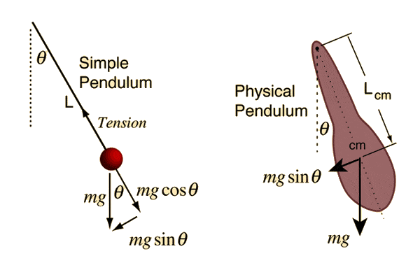

Okay...The time period of a pendulum is independent of its mass and amplitude.For the "independence of mass",the reason is that, for same amplitude (distance from mean position), any change in mass would have no effect on the acceleration of the mass (gravitational acceleration is constant);hence the mass will reach the mean position at same time...But for the "independence of amplitude'', the reason I found is that, for a same mass, increase in amplitude would result in increase in restoring force, which would result in increase in acceleration; increased distance would increase acceleration and hence the mass will reach the mean position at the same time...Now my question is that, are'nt these two reasons contradictory, like one says that acceleration remains constant and the other states that the acceleration would increase?Any help will be appreciated...
Okay...Any freely falling body on Earth will have acceleration of 9.8 ms-2.Suppose that in case of a pendulum, the bob is taken to the right of its mean position...Now only a ''component of weight'' will be acting as a net force on the bob...My question is that, will the acceleration of the bob in this case also be 9.8ms-2 (same as gravitational acceleration), or will it be different?

Well, it isn't exactly true for a pendulum. Simple Harmonic Motion is only followed when the restoring force is exactly proportional to displacement - as with a steel clock spring.
But there is no way to discuss the details of the motion without using Maths and solving the differential equation of motion. That's the only real explanation and arm waving cannot suffice, I'm afraid.
The acceleration towards the rest position is not constant but is proportional to the displacement. You have more or less described what goes on but what you can't 'prove' that way is how that effect produces equal time periods of cycles of all amplitudes. That has to use the Calculus.

With the bob at the same level as the pivot, the downwards acceleration will be g. Not for other angles, though. At other angles, the force towards the pivot becomes relevant and the motion is due to mg and the tension. This link says it all, with pictures.

That is the defining property of a harmonic oscillator: The restoring force and hence the acceleration is directly proportional to the displacement. That condition leads to a differential equation in which the amplitude drops out.
Ir is worth noting that a pendulum is not a perfect harmonic oscillator, but as long as the angle of swing is small enough that ##\sin\theta\approx\theta## and the mass is concentrated in a point at the end of the string it's pretty close.

The force of gravity acts down while the force which accelerates the pendulum is tangential to its circular motion. When the amplitude of the pendulum increases, the direction of these two forces gets more similar which means that a larger component of the force of gravity is rotating the pendulum. This force is Fgsinθ with θ being the amplitude. This is clearly shown in a image from the link.
Note that the force of gravity itself remains constant.
