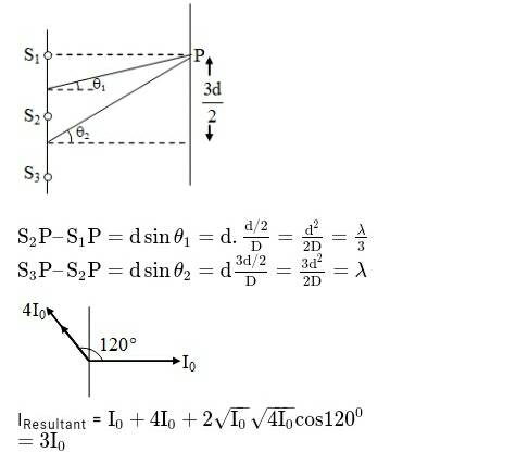

To find the resultant intensity
15 replies · 4K views · last reply
PSN03
100
Consider the interference at P between waves emanating from three coherent sources in same phase located at S1, S2 and S3. If intensity due to each source is I0 = 12 W/m2 at P and d2/2D =λ/3 calculate the resultant intensity at P.
I= I1+I2+ 2√I1*I2cosx
Where I=net intensity
x=phase difference
So I thought of calculating the path differences between all the 3 points by taking them in pairs of 2.
S1 and S2
S2 and S3
S3 and S1
I got the path differences as λ/3 , λ and 2λ/3
I can now find their phase differences using the equation
Cosx=2π/λ* (path difference)
Then I can apply the intensity equation to find 3 intensities obtained from 3 different pairs.
Is my logic correct? If yes then can I directly take the summation of these 3 intensities now?

You only need to find two phases, not three because it is the phase difference that counts. I would write the amplitudes for each wave,
##A_1=\sqrt{I_0}\cos(kD)##
##A_2=\sqrt{I_0}\cos(kx_2)##
##A_3=\sqrt{I_0}\cos(kx_3)##
then translate the cosine arguments into phases involving the wavelength, add the amplitudes and finally square. That would be safe.
No. That method wouldn't work. It would be like saying ##(a+b+c)^2 = (a+b)^2 + (b+c)^2 + (a+c)^2##.
When you have coherent sources, intensities don't add. Amplitudes do. You want to do as @kuruman suggests.

ohk,
so my strategy was to find the interference pattern due to the 3 sources by taking them in the pairs of 2
Δ ##x_1=S_1P-S_2P##
=D-(##D^2+d^2##)^(1/2)
=D-(D(1-##d^2/2D^2##)) (by binomial expansion)
=##d^2/2D##
= λ/3 (from provided relation)
Similarly
Δ ##x_2=S_2P-S_2P##
=##9d^2/4D##
=3λ/4
and
Δ ##x_3=S_1P-S_3P##
=##2d^2/D##
=4λ/3
Now we can calculate the phase difference using the formula
ΔΦ=2 π /λ*Δ x
Through this phase difference we can calculate the resultant intensity due to the 2 sources.
And as we know I is proportional to ##A^2## we can hence find A and perform its summation.
This was my working. Can you please point the mistake
You are not following my suggestion. Don't worry about path length differences. Start with ##\cos(kD-\omega t_s)=1##, a convenient choice of phase. It implies that the phase of ##A_1## is a multiple of 2##\pi##. This makes ##A_1=\sqrt{I_0}##.
Now find ##A_2##. You have found that ##x_2=D+\dfrac{d^2}{2D}=D+\dfrac{\lambda}{3}.## What is ##\cos(kx_2-\omega t_s)?## Hint: ##k=\dfrac{2\pi}{\lambda}## and you already know that ##(kD-\omega t_s)## is a multiple of ##2\pi##.

Actually I am not aware of the method you are trying to apply. I have never learned this so I can't apply.
And shouldn't ##x_2##=D-d²/2D?
By the way I have a solution to this problem and it is attached below.
I was trying to solve this problem by applying the idea from this solution though I couldn't do any good.
See you later then, good night.
  • Diagram of three slits S1, S2, S3 on a vertical line with screen point P, path differences written as d sin θ1 = λ/3 and d sin θ2 = λ, and a phasor diagram with amplitudes I0 and 4I0 at 120°, giving resultant 3I0.

In light of the above hints you dropped I can say
kD=wt+2πn
Hence I can say
Cos(k##x_2##-wt)
=Cos(k(D-d²/2D)-wt)
=Cos(-kd²/2D)
=Cos(-2π/λ*λ/3)
=Cos(2π/3)
=-1/2
Now according to the formula you have given my
##A_2##=√I*(-1/2)
=-√I/2
Am I doing right?

@kuruman I saw some videos online and I got the message you are trying to convey. You are going to find the resultant amplitude cause by 3 sources through the vector addition of individual amplitudes (or by their phasor diagrams). I now under stand what you were doing. If my interpretation was correct you are finding their phase differences by considering the first source as main source with no phase difference.
Now my doubt is if we take any two sources, they will produce an interference pattern on point P which will have some intensity I and some amplitude A.
Since there are 3 sources hence 3 such pairs are possible. So why can't we calculate the intensity due to these 3 interference patterns and find their amplitude and then perform the summation?

That's not how it works and @vela explained why in post #3. The intensity at a given point is the amplitude squared of whatever electric field exists at that point. If you have a single source it is the square of that single source and you don't have to add anything. If you have three sources, first you add as vectors the fields from all three to get the total field and then square.
My method is exactly that. Calculate the amplitudes, then add them then square the sum. The method of path length differences that you are trying to apply works well when you have either constructive (maximum intensity) or destructive (zero intensity) interference, but what is the intensity if the path length difference between two sources is (3/4}λ? You get "in-between" interference and to find the intensity you need to add the amplitudes and square the result. An example of in-between interference is this problem with S3 missing. The total amplitude from S1 and S2 is ##A_{tot}=\sqrt{I_0}+(-\frac{1}{2})\sqrt{I_0}=(\frac{1}{2})\sqrt{I_0}## in which case the intensity is ##I_{tot}=\frac{1}{4}I_0##.
You have made good progress and you calculation in post #11 is correct. Repeat to find ##\cos(kx_3-\omega t_s)## and then add the three amplitudes.

Really sorry sir...I got my mistake
I am sooo stupid to do such kind of mistake😅😅😅
I have got all the poin you are telling me. Thanks a lot sir
One last question...is this relation A=√Icos(kx-wt) valid for all cases?
