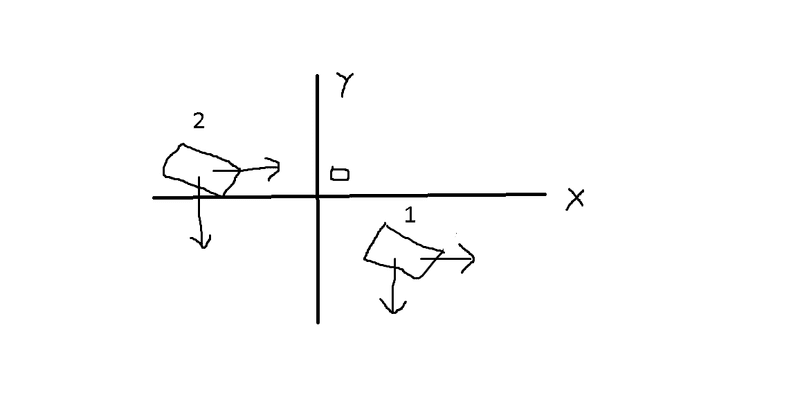

I am not able to understand how can only the normal horizontal force can slow the block. The block is not just moving in -x direction but also in the +y direction.I have drawn the fig of the two instants of time 1 and 2. Clearly the block is also moving along y axis. Normal and weight mg ,both should slow down the block.

Sorry, I got confused. I thought you were asking about the acceleration of the wedge.
For the block, there is a horizontal component of the normal force slowing the horizontal component of the block's velocity, while in the vertical direction there is the block's weight and the vertical (upward) component of the normal force. The weight has the greater magnitude, so the vertical velocity also reduces.

kuruman said:
In that case you cannot conserve momentum along the x-direction because the component of the weight in your chosen x-direction is an external force acting on the block.
And there will be no violation of momentum conservation in x direction but in y direction we cannot apply this law because there is mg and by the way we don’t have to.
  • #37
rudransh verma said:
I am asking if the block is moving up the wedge then it is acted upon by the downward weight and the horizontal normal force. You said the blocks speed will slow down because of the horizontal normal force even though the direction of the force is not opposite to the motion of the block.
Draw a correct free body diagram of the block and you will see that the horizontal component of the normal force on the block wedge is opposite to the motion of the block. While you'e at it, you might as well draw a free body diagram of the wedge.

  • #38
That would be true if the x direction is the same as the horizontal direction. If that is what you think, you are contradicting yourself. In post #22 you wrote
By taking the x and y-axis parallel to the slope and perpendicular to the slope of the wedge, I have drawn the fig. Please see. Clearly its the horizontal component of the weight of the block that is slowing down the block.
Unless the angle of the incline is zero, the horizontal direction and the direction parallel to the slope cannot be the same. Furthermore, you mention "the horizontal component of the weigh". You seem to be unaware that the weight does not have a horizontal component and that's serious. The horizontal component of the weght is zero no matter how you choose to orient the x and y axes. That's because the direction of the weight serves as the definition of "vertical". Have you ever wondered how people, since ancient times, were able to build vertical walls on sloped hillsides? How did they figure out which way is vertical?
