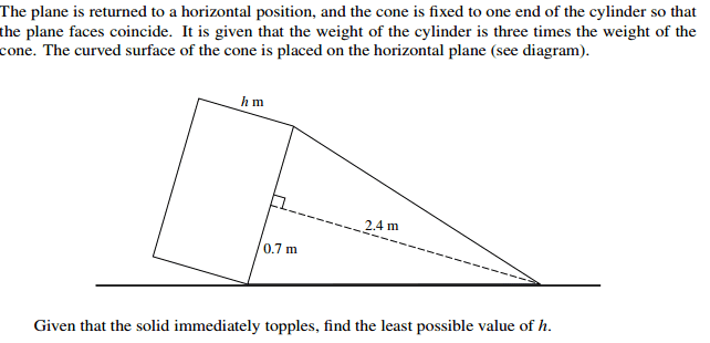

Hello, I uploaded an image of the question so it becomes clear
my main doubt is which procedure should I follow
1) total object weight*PERP. Distance to toppling point=Moment of cylinder+moment of cone
2) moment of cylinder ≥ moment of cone
I tried doing method two since they asked for least value and not exact
  • Diagram of a solid cylinder with a cone fixed to its lower end, resting on a horizontal plane on the cone's curved surface; labels show h m for the cylinder height, 0.7 m for a perpendicular distance and 2.4 m for the cone's slant length.

What do you mean by "distance to toppling point"? Distance from what to what?
