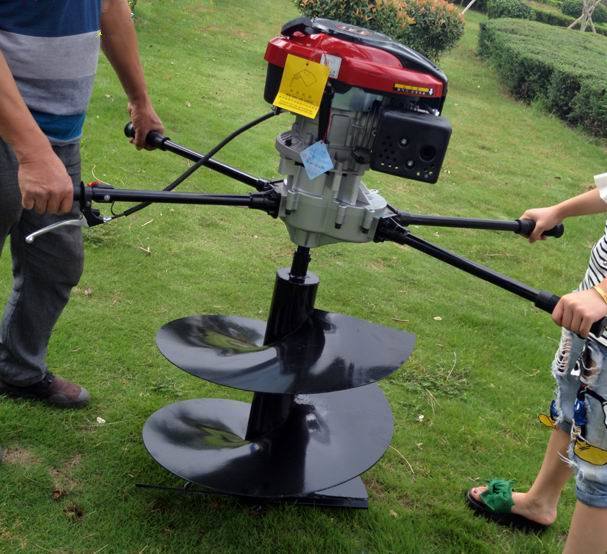

Trying to determine how the torques balance in a gearbox below
I read this in my college design book, that for a car transmission, if the engine provide T, and the output is RT(ratio x Torque), the difference of (RT-T) must be back on the engine mounting. This example makes sense, I am not questioning that.However, if i have an offset gear drive, like that below, where input gear is 2" diameter, has input torque of 10in-lbs, and outputs to gear of 10" diameter, output torque of 50in-lbs, when i do the math, i don't find the relation above to hold. What i find is the entire housing reacts with 60 in-lbs, but due to reaction of the motor, 10in lbs, the whole unit (gearcase and motor) have 50 in lbs, which is equal to the torque on the output.
Please see attached images. am I missing something? Or does this relationship not apply to this setup of gearbox
If I understand correctly, you're getting 60 in-lbs from the 10lb couple from A to B so 6in (1in radius drive gear + 5in radius driven gear)? If so, you're mixing up torques along different axes. RT-T still applies in the axis of the auger bit, 60in-lbs applies in the axis coming out of the page. Both torques are felt by the auger frame, and both torques are balanced by the end user. (If you didn't balance the 60in-lbs, you'd fall over sideways.)
Could you explain more or draw a picture?
IF i apply 10 lbs to the auger bit at 5 inches, that is 50inlbs, but the 10 lbs back on gear A, will act at the pivot, which is yes 6inches away, giving you 60inlbs.
How then is the RT-T still true. The auger bit gets RT, Tin is 10. So shouldn't there only be 40? perhaps you can draw it out.
Thank you
Actually, it might make sense. Looking at it RT-T works if you assume the direction of the torques. In this case, the torque to the auger bit is opposite of the input. SO 50 is RT, RT-T = 50-(-10), so it 60, so that makes sense

If the auger bit requires 50 inlbs in my example. The operator has to apply equally that to keep it in place. That is true and i am not questioning that.
What i was trying to learn is how much is reacted back thru the gearcase itself, minus the engine. Such with the sum, equals the output torque.
With the offset gearbox in my example, the gear case has 60 inlbs back, beecuase the of the 10lb force at 6 inches. But as the motor rovides 10 inlbs, has a reaction torque of 10 inlbs in the opposite direction, so it subtracts. SO the overall the operator still feels is 50 inlbs
IF i break down all the reaction forces and torques on each shaft, this comes out right and makes sense. Plus agrees now with the RT, RT-T etc. You have to use sign convention for direction of rotation

YEs, if you look at the math in my drawing and the clip from my textbook, i am looking at how the output torque, creates internal reactions torques/balances such that it takes an external torque from the operator to steady machine.
With auger, the motor puts in 10inlb to the drive gear, creating 50inlbs on the auger bit. This causes a reaction force of 10 lbs back on the drive gear, canceling out the input torque, but causing a force of 10lbs at 6 inches, so we get reaction of 60inlbs. However, we need to account for the reaction of the motor on the gearcase, this then subtracts. so the overall gearcase/motor has a -50 in lbs. IF the operators didnt hold the unit providing equal torque to the machine, it will just spin.

Think of the gears as of two levers connecting each other.
Each is anchored to a common base (chassis of machine) via pivots.
You have reactive linear forces at those pivots, both are 10 lbf, just like the forces between the teeths in contact.
The torque induced by the reactive 10 lbf acting 6 inches away from the center of the bit is counter-acted by the 10 in-lbf torque of the engine, resulting on the 50 in-lbf torque felt by the operator.
Then, you have a pair of forces acting at the anchorage points of the motor to the chassis.
The magnitude of each of those forces equals torque of 10 in-lbf times radial distance to engine shaft.
But again, those are internal forces of the mechanism.

So you agree with me given you 'liked" my comment above correct? There is a reactive torque created by the auger bit of 60 inlbs. The motor reaction torque is -10inlbs. Sum of these is 50inlbs. However, you are right, these are internal on the mechanism, so the overall auger head(gearcase and motor) rotate opposite of the auger bit(or as the person spinning lol)
THis is why to drill a hole you need to apply 50 in lbs.

Yes. ✅
Note that the reaction from the ground does not touch the chassis until it reaches the anchorage bolts of the engine.
Then, from there to the hands of the operator.
Each link of the chain of transmission may be “feeling” loads that are different among them, but again, all those don’t make any difference on output-input of forces and torques.

In the end I agree, without the bit in the ground to create the load, then the operator would feel very little. As it takes the 50 inch lbs to drill ice then the operator must apply 50 in lbs back. You can break it down piece by piece or look at the aguer as one unit, still comes out the same
It is however interesting to learn how internally the reaction forces generates a large torque to balance out the motor and such, keeps everything even. We mainly take it for granted, that what you get out, you know you have to equally support
