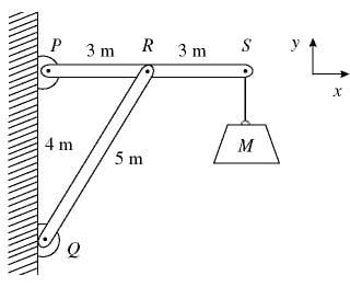

A uniform 300-kg beam, 6 m long, is freely pivoted at P. The beam is supported in a horizontal position by a light strut, 5 m long, which is freely pivoted at Q and is loosely pinned to the beam at R. A load of mass is suspended from the end of the beam at S. A maximum compression of 23,000 N in the strut is permitted, due to safety. In Fig. 11.1, the maximum mass M of the load is closest to:
Diagram of a horizontal beam pivoted at P on a vertical wall, with a diagonal strut from Q on the wall pinned to the beam at R; PR is 3 m, RS is 3 m, the strut QR is 5 m, the wall segment PQ is 4 m, and a mass M hangs from S.
Net Torque=0
Net Force=0
I tried adding up all of the torque moments and then setting them equal to 23,000N.
300(9.8)(3m)+0(Pivot arm)+6m(mg for the mass)=23,000
Then I set that net torque equal to 23,000, isolated force of the mass, and divided by 9.8 m/s^2 in order to find the maximum mass. It's still wrong, and I don't know where to go from here
You should start from writing down the equations of equilibrium. Don't plug in any numbers just yet, use letters for everything.
Just figured it out.
I have to take the 23,000 maximum force into account that is exerted upwards.
So Net Torque=
0(0)(at the Pivot P)+ (-300kg*9.8)(3m) + -x(6m) + 23,000(4/5)
Its 4/5*23,000 because that is how much is being exerted upwards after looking at the triangle.
We solve for x, and divide by 9.8, to get 788 Kg
