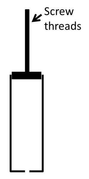

You have a disc of diameter 1.4cm and height 1cm. The disc is connected to a rod of diameter 0.8cm and height 7cm. The disc and rod have a density of 7800kg/m^3. The disc and rod have been inserted into a barrel of diameter 1.4cm in order to extrude a fluid. You want this disc and rod to exert a force of 622.6 Newtons on the fluid. What torque should you rotate the disc and rod assembly by?
There is a picture too, let me know if you need it and I will scan it for you.

is the barrel rifled (with a screw thread)?
(the force is given in Newtons, and the cylinder can be pushed, so where does torque come into it?)
would you scan the picture? :smile:
Hi Tiny-Tim,
Yes the rod has screw threads at the top so the rod needs to be rotated for the rod and disc assembly to advance down the barrel. My scanner refuses to work so I have drawn the picture instead. The picture is attached here. Thanks.
ahh!
then we need to know the pitch of the screw thread
ie, how many turns per metre? :wink:

great, so how do I go about calculating it? I have Iz of the disc, now what do I do?
what do you think?
I don't know how to apply torque = force x distance on a disc? And where the Iz value comes in? I only calculated Iz cus the hint of the question gave the Iz formula for the disc.
i don't think the mass or the moment of inertia of the disc is relevant …
it isn't being accelerated, so it doesn't itself need any force or torque
