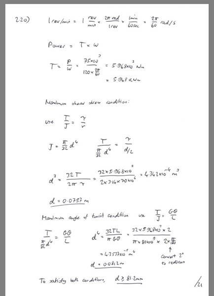

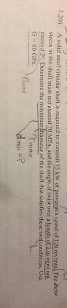

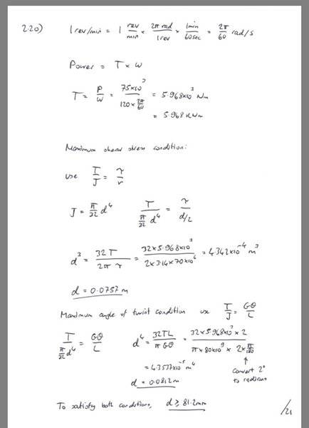

Hi, below i have attached a exercise sheet question with the solution, however i don't quite understand it. In torsion, the maximum shear stress of a shaft is determined using the max radius of the shaft. Also, when comparing two sections, the one with the larger radius gives a higher shear stress value. After rewatching the lecture, the professor said that a larger radius decreases the shear stress. I find this contradicting & now I am confused as to why the maximum diameter in the solution below gives a lower shear stress.
  • Printed textbook problem 2.20 on torsion of a solid steel circular shaft: transmit 75 kW at 120 rev/min, shear stress limit 70 MPa, twist limit 2 degrees over 2 m, G = 80 GPa, find minimum diameter d_min, with handwritten annotations tau_max and d_min = ?

  • Handwritten worked solution for a shaft torsion problem: power and angular speed conversion, torque T = P/ω = 5.968 kNm, maximum shear stress design for diameter d = 0.0757 m, and maximum angle of twist design giving d = 0.0812 m, concluding d ≥ 81.2 mm.

I can’t read some key features of this because of your poor handwriting. Please use LaTex to display your equations.
