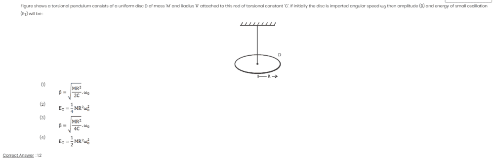

The question was:

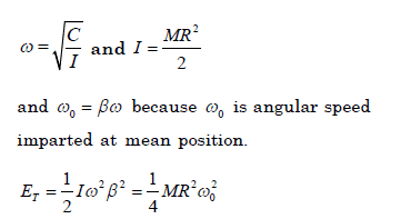

I will also include the solution:
So, what is the justification of the first formula [ω=√(C/I)]? I know how to derive simple harmonic equations, this one as I guess is probably similar? But I cannot connect as to how C is used exactly.
And the second formula [ω'=ωβ], I don't know why is it used; I'm clueless about it. Can you throw some light on these topics?

I can explain the ##\beta, \omega, \omega_0## part.
The two ##\omega##s represent quite different things. ##\omega## is the angular frequency, i.e. as in ##\sin(\omega t)##. For a rotational oscillation, as here, there is also the rate of change of angular position. So if ##\beta## is the angular amplitude then ##\theta=\beta\sin(\omega t)## and ##\dot\theta=\beta\omega\cos(\omega t)##.
They have, confusingly, used ##\omega_0## for the amplitude of ##\dot\theta##.

In the question, the max angular speed is ##\beta\omega##, so the max KE is ##\frac 12I\beta^2\omega^2##.
The max twist of the fibre is ##\beta##, so the max torsional energy is ##\frac 12C\beta^2##. These must be equal, so we have ##C=I\omega^2##.

Yes, and ##\theta## is the angular displacement so ##C\theta## is the torque.
So to complete my correction, think of C as like the k for a spring: it's the torque per unit twist, and the stored energy is ##\frac 12C\theta^2##.
