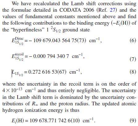

I'm not sure this is entirely correct if you are equating the 13.6 ev to energy needed to break the hydrogen bond (dissociation energy). As far as I understand it the 13.6 ev is the ionization energy of atomic hydrogen (energy needed to enable transition of electron from n=1 - ground state - to n=∞). If you have 'atomic hydrogen' then necessarily the H-H bond has already been broken.
https://research.vu.nl/ws/portalfiles/portal/2485538:
All a bit beyond my 'ken' admittedly!

$$ E_i=E_∞-E_1=μc^2\left(1-\sqrt{1-α^2}\right) J $$ with corrections for recoil energy and 'ground state Lamb shift' as per attachment above. It's negative because for some reason the electron is deemed to have zero energy when it's in the excited state (??) and therefore loses energy when it falls back down to ground state.
μ is the reduced electron mass and α the fine structure constant.
