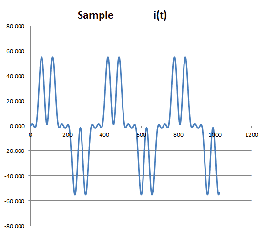

estimate the total harmonic distortion in the current waveform using the formula below
see attached pdf
i have started by taking the rms values of the results from the spreadsheet making:
I1= 2.818 amps
I3=2.095 amps
I5=1.767 amps
i then added I3 and I5 to give me 3.863 amps which i then input into the formula to yield a result of 135.202% which seems way off to me, any help would be greatly appreciated

I can't see these come out: how did you do that ?
And: why do you call them like that when they are at 50, 250 and 350 Hz ?

I'm pretty sure the THD is huge when I look at the signal (did you ? It looks horrible ! ) ,
but not 135.202%.
Several remarks & 1 question :
244980
So the whole sample represents 57 ms --- not a nice multiple of the main signal period of 20 ms which means the Fourier peaks are smeared out

Looking at the sample one would expect a 300 Hz peak, but it gets split up in a 250 and a 350 Hz peak. My trigonometric math is rusty, but I suspect it's because of a multiplication

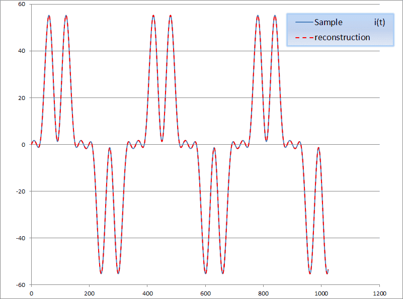

Because I like the subject, I played around a bit more and found a much lower THD than you did.
With a bit of handwork the sample in column B can be reconstructed almost exactly by adjusting ##a, b, c## in ##\ \ a\sin(2\pi\, 50t) + b\sin(2\pi\, 250t) + c\sin(2\pi\, 350t) ##
This bypasses the distortion from extending the 1024 point sample as if it were exactly one period of the original signal, which is clearly is not (it jumps from ##-##53 to 0 when going from 1023 to 0 again)
I don't want to hijack your exercise, but the amplitude ratios I found that way are nowhere near your I1 : I2 : I3
Oh, and in the preceding post forget my remark on trig multiplication.

Now, this is where the interesting part begins for me:
Your signal in column B is equal to $$\ \ 32.528\sin(2\pi\, 50t)
-19.5132\sin(2\pi\, 250t) + 11.709\sin(2\pi\, 350t) $$
245289
Amplitude ratios are 1, 0.6, 0.36 which in the formula yields THD 70.0 %.
So -- due to the mismatch between signal period and sample size the peaks smear out and the THD estimate is 40% higher. A considerable effect, some of which may be recovered by taking the area of the peaks instead of the height.
